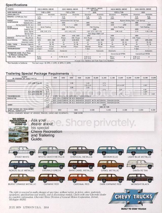

GM made a 4x4 trailering special Suburban. There is an '80 3/4t Sub around here with that emblem. I believe is says 13,000# towing capacity and has a 400 sb TH400/NP205 & 14BFF w/ 4.56 gears.
Yea, that is exactly what this one says. 13,000lbs. It has all new bagdes lying in it. Along with a lot of interior pieces. It looks like he was going to do a lot of work to it someday. There are boxes full of new parts from GM that never got installed lying in there. We also have a doner burban that we are going rob the rear air out of. (one thing this one didnt have) Scored a nice set of rims and decent used tires for it today. ...

13,000 wow that 3000 more then my one ton.
Not saying it will do it... But thats what it says! I click some pics of the badging next time Im over there. (its in my sisters back yard right now) Its really shocking since best I can tell it came with a 350. Guy said he bought it from his dad who bought it new. It had a 350 / 400 with a gear vendor. I would have at least expected a big block.
Wonder what they did for springs think mine is like a 13 with a overload or maybe a nine pack. Would be cool to find one here since Utah lift laws are based on weight.

Here's a link & a pic from Dremu's awesome site. With the trailer weights for a 1980 Sub.
http://brochures.slosh.com/
