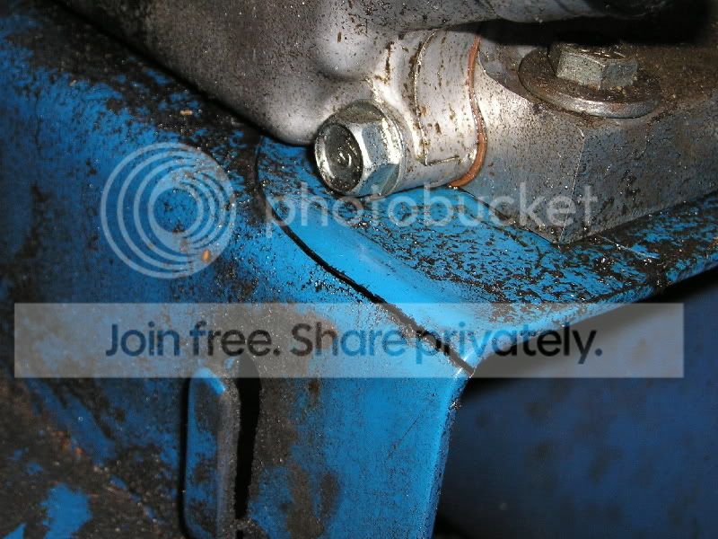

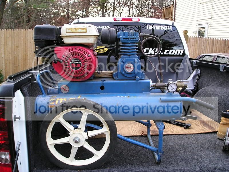

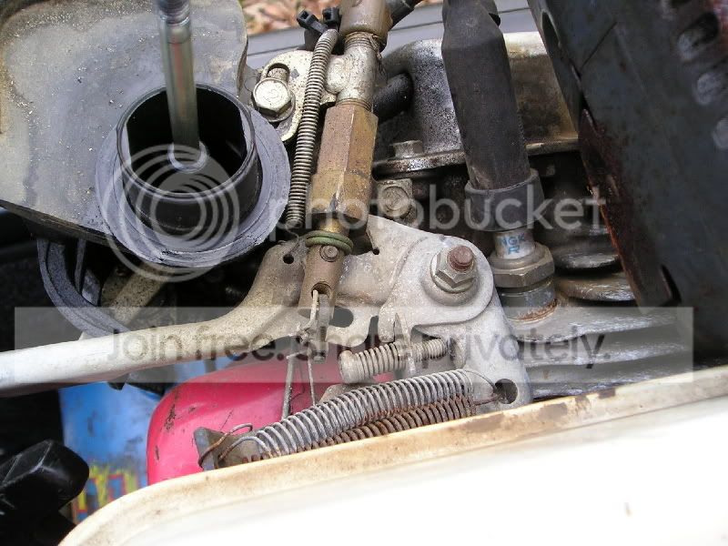

I picked up this compressor today. It has a twin cylinder pump and a 5.5HP Honda engine. Runs great. Wasn't looking for a gas unit, but I don't have proper electric to run a 220V unit at my house. Need the electric co. to run some new wires down the street. Anyway, got it for 300. Thought that was a good deal. I need to weld some reinforcement to the motor mounting plate because of the crack. Also had to put new gauge and coupler on due to leaks. I have never used a unit like this before. It runs until the pressure reaches 160psi, then the engine idles down and air purges out of somewhere for a few seconds bringing it down to 120psi, then the engine revs up again and pumps to 160. This cycle continues over and over. Is this how these units are supposed to run? I think it is supposed to stay at 160 until I use some air and when it gets down to 120 it should kick back up, but am I wrong? Please school me on this. The third pic is of where the pressure line runs to the carb to kick the idle on and off. Not exactly sure how this works either.

good score..
A compressor like that is hard to find for less than 500 bucks with a Honda motor on it...you did OK!..
Most compressors with gas engines are "continuous run" --they do just as you said,pump up to the maximum pressure allowed by the pressure switch,then a valve opens to let the pump "frewheel" instead of pumping more air,by holding one of the valves in the compressor pump open...then after pressure drops below a set PSI,the valve closes again,and lets the pump pressurize the tank again..and the cycle repeats over and over..there is a safety "blow off" pressure relief also,if for some reason things dont work properly,that will not let the tank over pressurize (all compressors have one)..
The throttle is controlled by a small air piston on most gas powered rigs..when the maximum PSI is reached,and the valve opens in the pump to let the pump frewheel,it also sends air to that little piston,which kicks the throttle back to idle..when it starts pumping again,that piston loses its air pressure,and the govenor takes over the engine RPM speed..

It seems to be working exactly as you stated. I wasn't sure if it was supposed to hold the air from bleeding off, but it seems that is the way it is designed. I plan to weld up a new mounting plate this weeked, change all the oils, and get some wheels for it, and I should be good to go.
