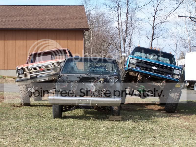

does anyone have pics of some 15x10 wheels with 2.75 back spacing with the wheels mounted on either a 3/4 ton front or 1 ton???
i want 15x 10 wheels but i'm not sure on the BSing. i want to see how far they stick out. i'm just scared i'll be going through balljoints on my 10 bolt

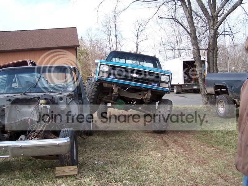

Clicky on my photobucket link. Those wheels are 15/8 on a 1 ton w/2.5 bs. If you go through my folder links on the left somewhere there is a tailgat shot, shows you how far they hang.
As an added bonus, I ran those wheels when I ran a D44. I changed ball joints every year. But I also broke the cross pin in the front locker, so you have to know I beat the piss out of it.

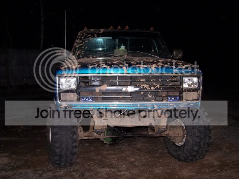

Thats my account, but Im at work and photobucket is blocked, but i have 15x10 with 2.5"BS with 38 TSL's. about 3/8's of the tire is outside the wheel well. I did the 2.5" cause i wanted stability and i already had 15" tires(i have a 60 up front, didnt wanna mess with grinding)
