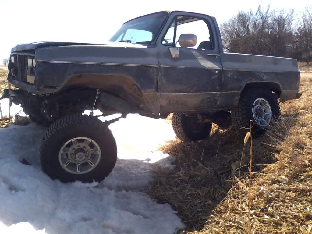

On my 1990 K5 I have the Dana 60 moved 1.5" forward and I am just using the OEM quad shock mount.

82355 (hmmm.....is that a prisoner #? :rolleyes:) - If I don't have to move my shock mounts that is great. I'm starting to wonder maybe the extra angle on the shock isn't going to be an issue. I thought ideally they should be nearly vertical, but maybe I'm over thinking it?
I don't think the angle would be bad. Look at the rear, think that has more angle....
What's nice about 82355's setup is it uses factory shock mounts. The second shock in a "Quad shock" setup is much more vertical than the standard one. Grabbing a couple quad shock mounts, moving the axle forward, and mounting a single shock in that upper mount sounds good enough to me. :D
The quad shock route sounds like a good plan.
