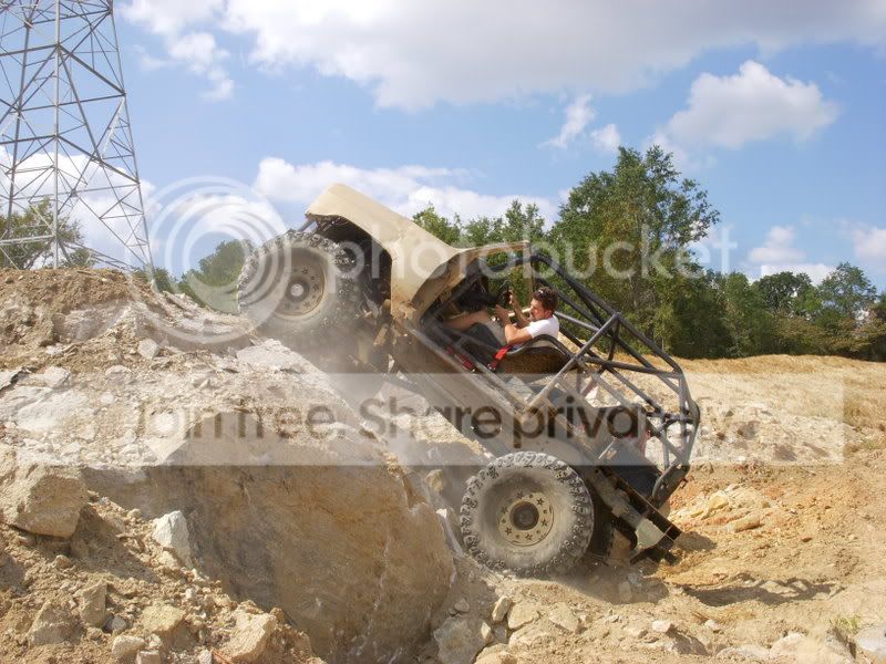

I have about 1k in my cage... Its all 2" 120 DOM... but I still have a 20ft stick left... I think of cages the same way I think of helmets... If you think you are worth $300 then build it out of pipe... If you value yourself more than that then do it right. Here is a pic of mine
