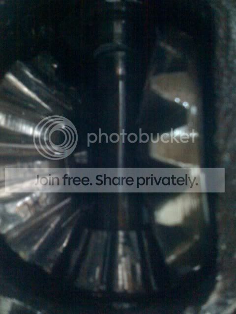

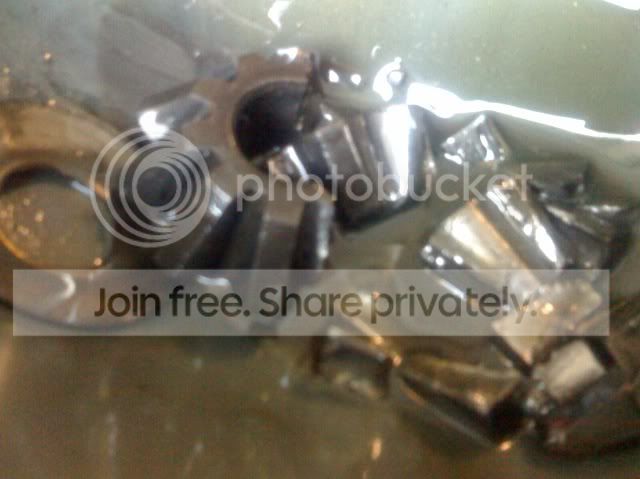

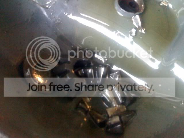

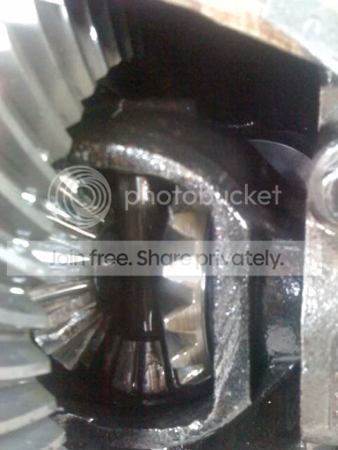

So I finally pulled got the front end up in the air and played around with the wheels and driveshaft. The hubs and u-joints seem to be OK. I pulled the diff cover, and found this inside:
When it broke(when I was stuck in the sand), I'm pretty confident the front diff didn't rotate at all, as the ring gear looks to be in good shape.
Is this what I need to fix it, I'm a little confused since it says rear. The D44 has an 8.5" ring gear, yes?
http://store.summitracing.com/partdetail.asp?autofilter=1&part=SAG-85-2021A&N=700+115&autoview=sku
And is this something easily installed in my driveway by someone who hasn't done a whole lot of work before?
The ring and pinion will spin as long as the t-case is in 4WD or as long as the hubs are locked in. Check all of your ring and pinion teeth.
yep
Its easy, you don't have to pull the carrier.

Simple to do if the gears look allright . Your going to want to buy as much brake cleaner as you can afford and flush that thing clean , since little shavings are all over your bearings .
I would run synthetic shockproof fluid when your done . It really does cling to the bearings and gears better than normal stuff .
And Diff can spin all it wants with driveshaft , no spiders = no axleshaft movement .
