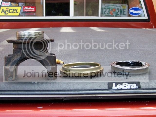

I'm trying to put in a new pinion seal in my front 10-bolt. I finally got the old one off only to find out that the seal i got from AutoZone doesn't look like the one on the truck, nor does it fit. Did they make different versions of the 10-bolt? The gears had 1978 engraved so i figured this was the stock axle.
The seal in the middle is from AutoZone for a '78 K10.
Most likely you were given a seal for a Dana 44 model front axle. Go back and ask for a 1985 year model K-10 ( The parts persons listing should only list a 10 bolt in that year and it will fit a 1978 10 bolt as well ) .

Thanks, I can't find any front axle seals instock. Would a rear 10-bolt pinion seal work?
Think about what you are asking for at the parts counter - You are asking for a front AXLE seal not a pinion seal for the front housing . Some parts people do not know the difference and just go by what the screen in front of them pulls up by key words given.
Yes , the rear pinion seal will work - it is the same .
