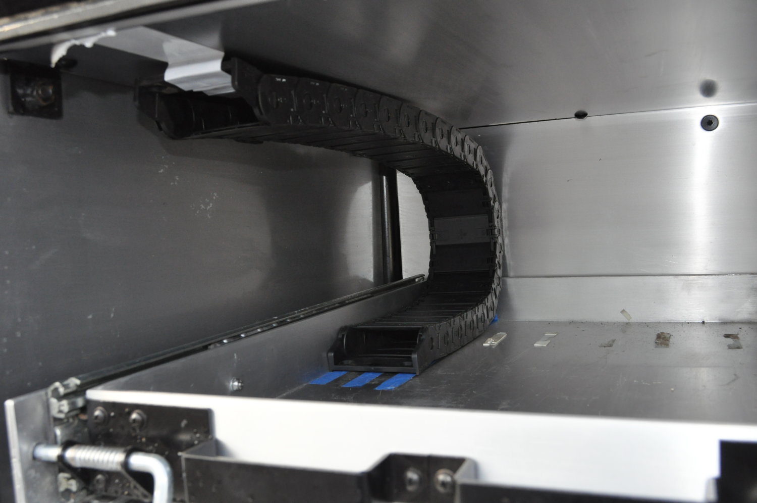

is it wrong the first thing I was checking out was the cable carrier? ;)
