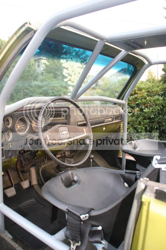

mine are actually the summit seats too. I don't think I have any pics on hand, but i could go snap a couple if you really want them. It's pretty straight forward. I just used some angle iron, drilled holes for the bolts to go through. Then I notched the angle iron so that it would sit over the top of the tubes nicely and welded it in. :)
this pic doesn't really help, i suppose:
the angle iron sits on top of the tubes that go across the body. you can see the angle iron flush up against the seat on the passenger seat.

maybe this one helps a bit more:

ColbyStephens: The shoulder belts should be mounted at or just slightly below shoulder level else the spine will compress on impact. The belt manufacturers have some good documentation on this.
Can you elaborate on this? I don't quite understand how that is possible in a belt that doesn't self-tighten. the holes in the seat which the belts pass through are at shoulder level, so it seems to my uneducated mind that this would act in the same way as mounting the belts at shoulder height. I'm happy to move them to a safer location if it is necessary.

http://www.circletrack.com/techarticles/nascar_seatbelt_system_tech_inspection/index.html
"If the upper attachment point falls significantly below the driver’s shoulder, then a spinal compression injury is likely to occur. In an accident, the shoulder belts pull down and back on the torso as they resist the forward motion of the driver. The resultant restraint force compresses the spinal column and will add to the stresses in the spine already caused by the force of the crash impact."
It looks like if you move the mounting point to the bar behind your seat headrest you will be close. Perhaps 2-3" higher than the current bar placement would give you level or a few degrees down.
