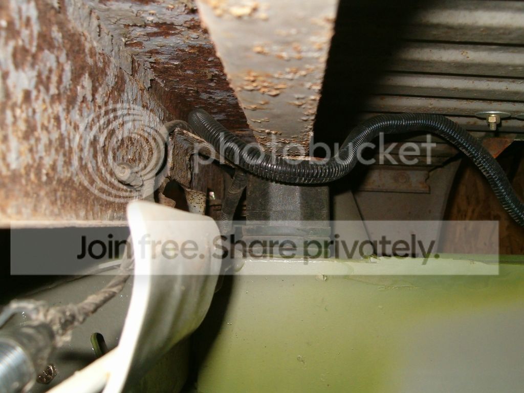

I was looking thru one of the build threads and came across this pic of plastic wire loom wrap. I HATE this stuff as it dry rots so fast and then of course crumbles all over the place. Is ther an alternatives to use besides this crap to wrap wires in? And no I don't want to spiral wrap wires in electrical tape. I want to be able to add a wire in the loom if necessary and remove wires if necessary too. Anyone have any ideas on other products out there for this application???
Strange, I love that stuff. I pulled all my factory (90 Suburban) looming off and it was all in good shape, the tape was even there. I just reloomed the entire harness as I checked it for shorts and such. I never had a prob with it rotting. Must be a location thing.
I hate the plastic stuff too. There's a nylon webbing loom that painless performance sells in different sizes that I like better, but is expensive. I think it's also available at Fry's Electronics for a lot cheaper.
Rob, there is a high heat version of that convulted tubing that is much better. Your local auto parts store will either carry it on the shelf or can order it for you.
Dry rots so fast? Yeah, maybe the stuff made in the 80's only lasted a couple decades (!), but some of the new stuff is great. I've been putting it on my wiring a dozen years and don't see any that has degraded. I've never found anything degraded at all on my 97 or my 93. My only complaint about is it's hard to clean the mud off.
You can get solid sleeving to put wires in, but you have to de-pin connectors and plan very carefully for changes and stuff. The split tubing lets you track down problems without wrecking anything.

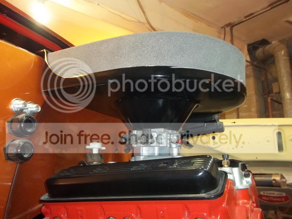

I'm gonna run liquatite's one conduit in black
running into my waterproof fittings
not nearly as user-friendly as a split, but should be pretty stout....
