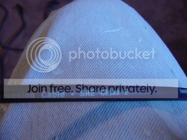

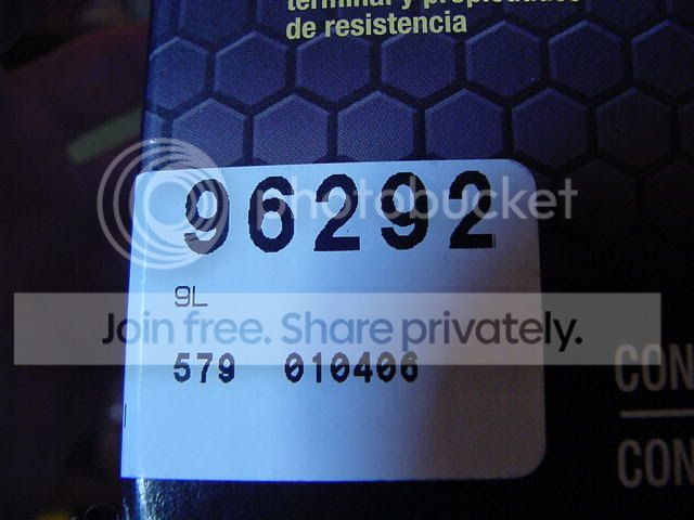

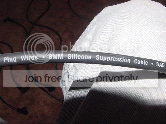

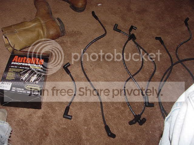

Has the parts store screwed me over again? They typed in my truck's make and model into their cute little computer system. I got a set of autolite plug wires. I've never bought a set of plug wires for an HEI dizzy before, but is there a difference? I noticed they wire set has one of those cute little miget wires that is supposed to go from the coil to dizzy cap on a points ignition. I have HEI. So will these plug wires set down correctly on my dizzy and plugs?
thanks soo much :bow: :bow:
I really appreciate the help. I wanna get out there and put these on the truck, but I don't wanna get them dirty if they aren't correct.
thanks,
James
They stick those in there so the set is more universal, just throw that away and stick'em on, dont try and overthink it, good luck
HEI distributor caps have a stud, which the spark plug wire snaps onto. The old pionts type distributor caps have a hole, which a spark plug wire with a longer tip slides into the distrubutor cap. Look at the end of the spark plug wire, which connects to the distributor, and see which type of end it has.
That short guy's for the coil on the TBI trucks. The coil isn't inside the cap like it is on yours in the 87 and up TBI trucks...it's an external coil. They're the right wires! Just don't use the super short one.
