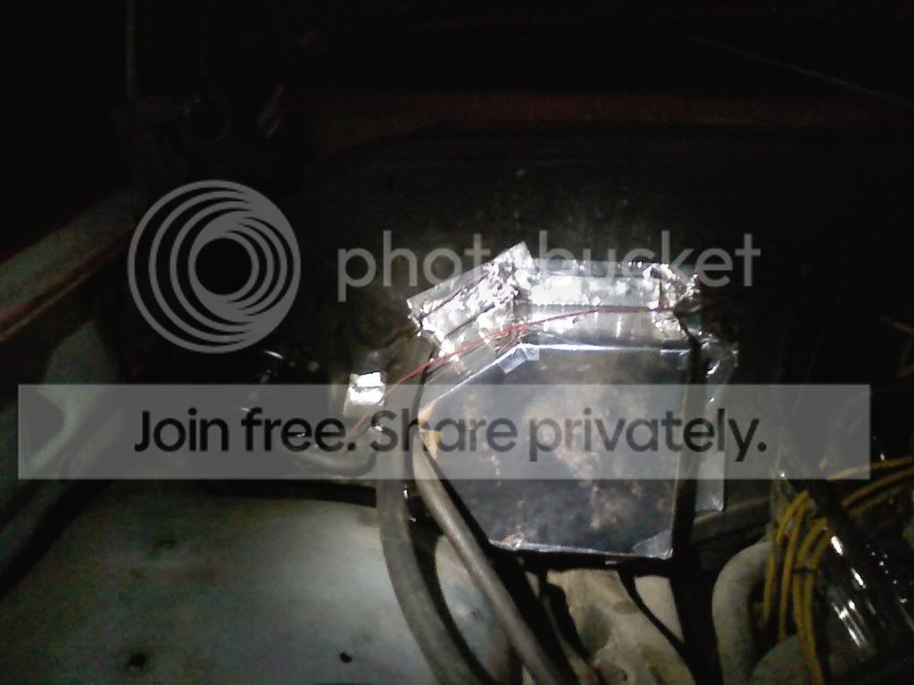

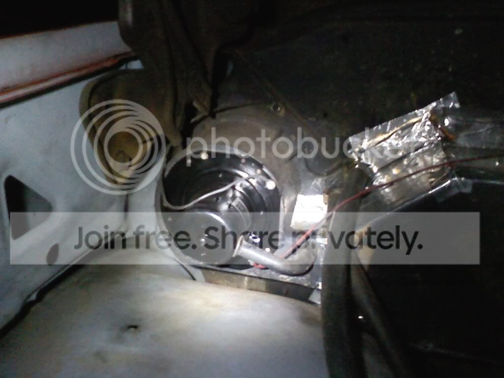

olen, I ditched my A/C and ended up making my own box out of thin gauge steel. I did however leave the original part where the blower/fan bolts up. Basically all you need is a round hole to mount the blower in the box that pulls air from that side of the firewall and blows it through the door in the firewall. I just ran outside to snap a few pics....(man it's cold..hahaha)
it does pretty well... not quite as good as stock heat, but decent... fan blows like a mutha on high...
