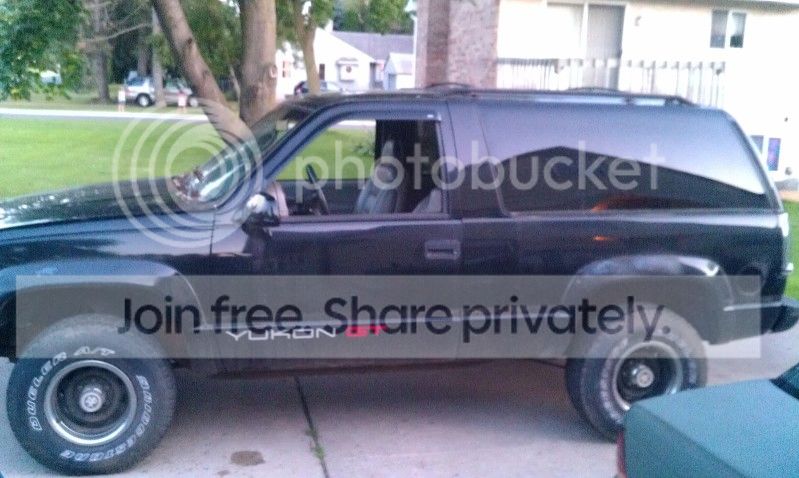

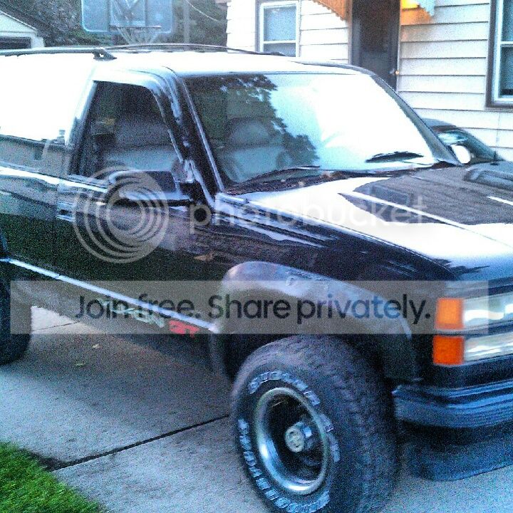

and here is some pic of her and her name is short circuit
Nice Yukon!
