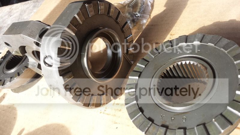

I bought this locker the other day. Can anyone identify the brand?

That is correct. The lock right replaces the spider gears so you will need an open carrier.
I got an open carrier with the locker but I was confused when the instructions say I need an open CASE, open gears and long pinion shaft.
Here's what came with the locker. I have measured it and it is a correct 4.56 and up carrier.
