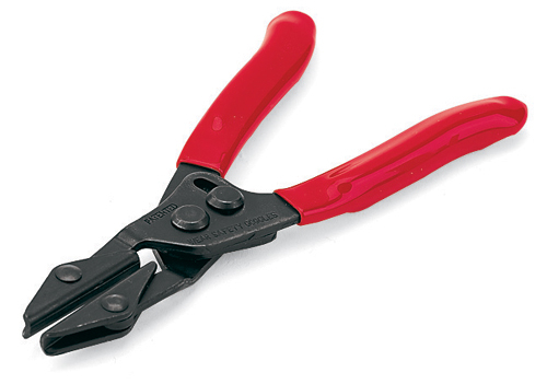

as said vise grips ( needle nose wider surface area less damage ) can be used light pressure is all thats needed . but left on to long can cause the hose to go bad .
braided steel line = DO NOT CLAMP HOSE as it will damage it .
i have 5 pair of these in the small size from blue-point php-3
