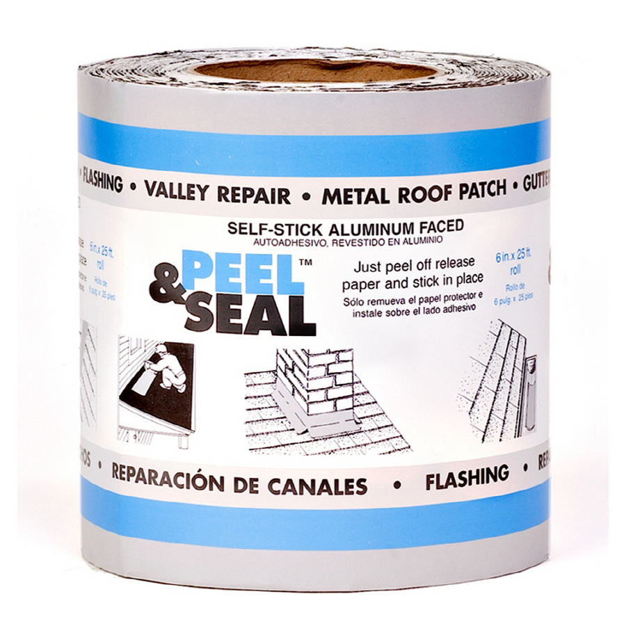

Some of the hot rodders and stereo guys are using this stuff, its much less expensive and available at Lowes and HD
I am going to have to check this one out if I need any extra material anywhere. I knew I had seen this sometime in the past, but didnt know where it was sold, or what its original use was for. Now I know, thanks.
