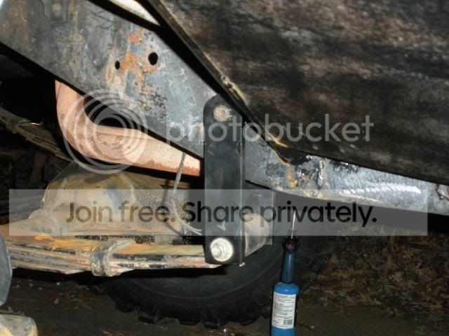

i dunno but it broke pretty easy in a off camber hole.it was totally twisted.it was in the truck when i bought it.look here
bent the top bolt as well.yall got part numbers?id rather not order from ord.
