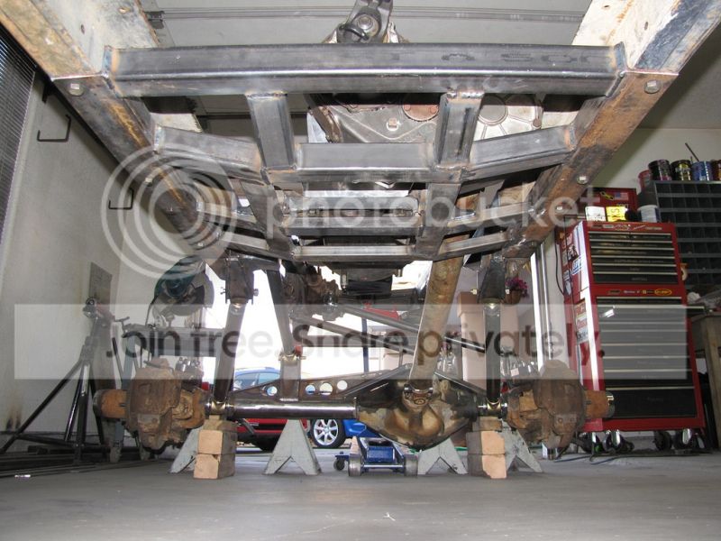

Which crossmember would you be talking about? When I go doubler I plan making a new crossmember for the trans/doubler. I've posted this picture before, but I plan to build one similar to this picture that I took off pirate.
Engine cross member and the rear crossmember . mostly the engine cross member though.
When you make a flat belly like that make some brackets to triangulate the top of the frame rail too.
