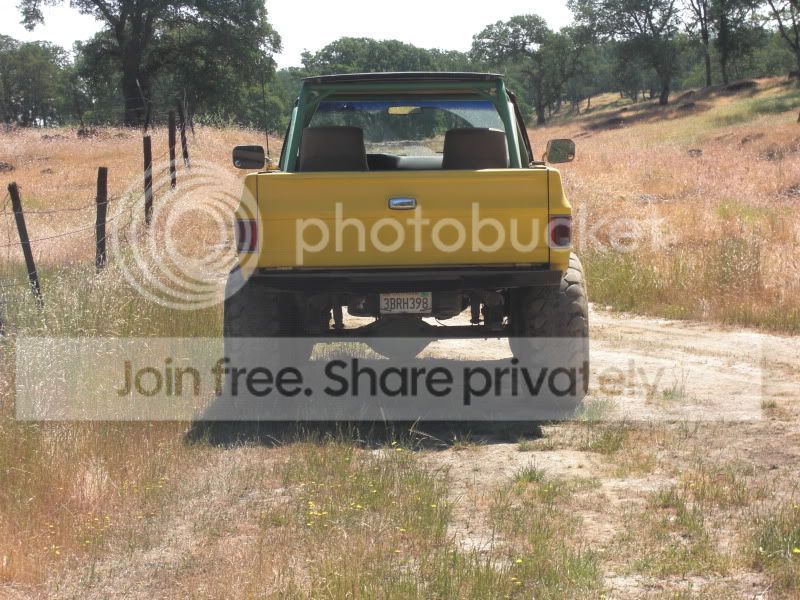

Thoughts? I'm seriously considering this just worried about support.

I live in New Mexico and with my light skinned kids this was way cheaper than a soft top.The weather here kills vyinal tops about 3yrs and they are no good.560972_4375347909850_8929328_n.jpg
how long has it been cut like that? how well is it supported? how much did it weight after glass removal and cutting?

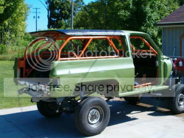

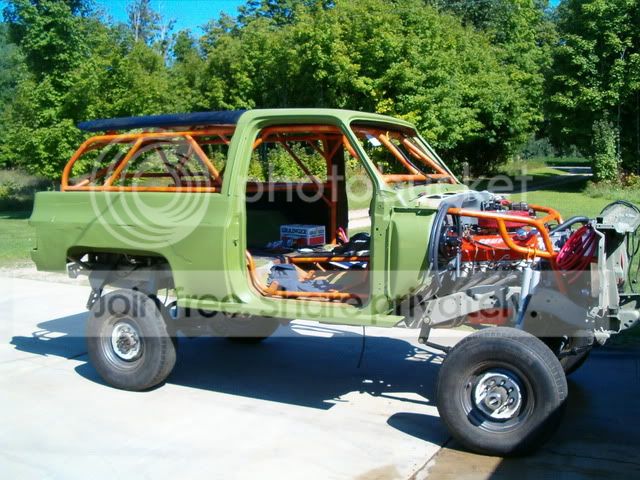

I really like the way Dave did his Iron Maiden rig...cut the top portion off and mounted it to the roll cage...it's in here somewhere...post #2478 on page 50 :bow::bow:
I have had mine cut for 2 yrs now and it is still hanging in there,I havent wheeled as hard as some of you.The top has its bolts in to the top of cab and I added 2 holes to the side corner in the rear,the back glass has not been on truck in 3 yrs so not sure if it would even work like this as for weight I kno it was heavy for 2 people when it had glass and sides but 2 people can grab it and throw it on
Hmmmmmmmmmmmmmmm how much weight did you lose hacking it up like that? I love this idea
I'm mainly curious if it made it more or less manageable to move? I would consider putting my top back on for the shade in the tx heat if when I hacked it up like that- which looks AWESOME btw- it was significantly lighter.
It is lighter for sure without the glass,mine was sliders.The only thing is there is no where to grab to set it on the truck with a 6in lift and 35's it was hard with a 4ft 9in helper

What did you use to cut the top up? Have any up close pictures of the cuts and what parts of the supports show through?

I used a sawzall and angle grinder to cut mine.The supports were the hardest part to cut straight and leave the dome light in the rear.
