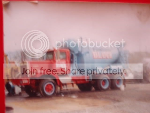

I do know things like cement trucks here painted with zinc chromate and topcoated with Imron still look like they were just painted decades later,despite the harsh environment they work in and being steam cleaned often..

Ryoken has, cement trucks here painted with zinc chromate and topcoated with Imron still look like they were just painted decades later,despite the harsh environment they work in and being steam cleaned often..
