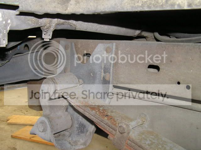

I went trough it all and I am still kinda lost. What else do I need to get? there is no rust what I am gonna be painting, its just to prevent rust. Also I was gonna paint the frame too. I was thinkin for the frame to use eastwood Chassis Black. Should I use POR15 under it or could i just use chassis black. Cause I only got a quart of POR.
here is a pic of the frame all the frame is like this except the front which still looks black color.
If you read his thread than you saw my comments on the Eastwood stuff. Not a fan.
POR15 requires all 3 steps of their system to work correctly for sure. It's like Herculiner or any other paint system...prep, prep, prep, and follow the instructions...then prep some more.
