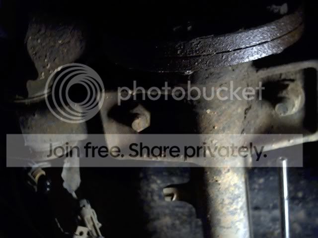

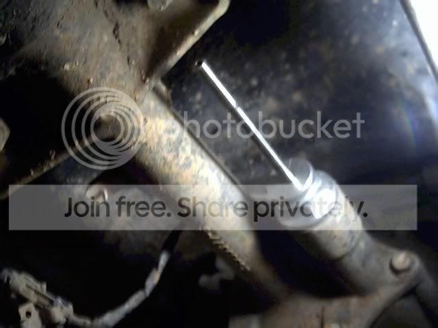

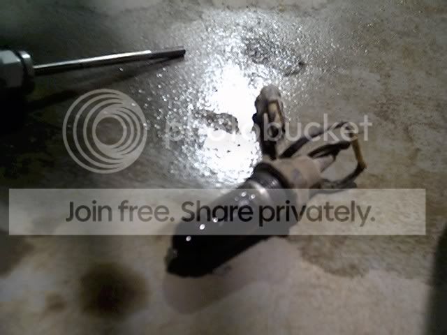

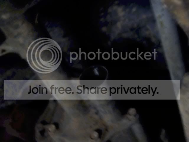

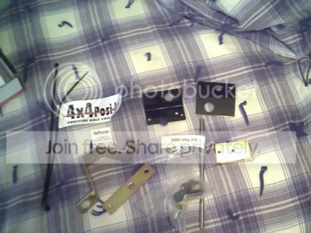

Totally worth it Randy. Let me check if I have pics of the install, it only took me about 30 minutes.
looks like I forgot to take pics during the last half of the install.

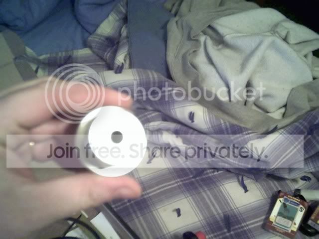

One you change the actuator out for the rod and bushing, theres a pivot tower that bolts on to these 2 large bolts.

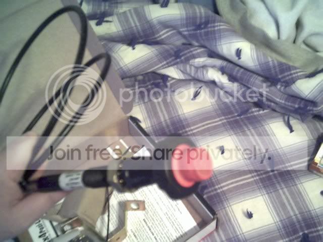

The cable (after being routed) attaches to the tower and a arm that pushes the rod in.
Its realy easy and the instructions are easy to follow.

I just had mine mounted under the dash like they recommended. If I remember correctly the bracket is made to fit some pre-existing screws under the dash...I think...
That said I did see where someone modified the lower section of their dash so that the handle came right out of it. I believe they had also painted the handle so it matched the gray-black of all factory controls.
I got the ugly dash so it probably won't look right anyways :rolleyes: Just thought i might find a pic of someones done
You've got the same dash as my '92 and the truck I'm thinking of had. He just drilled a hole in the plastic and mounted it all behind there, stuck the handle through, and whalla, semi-sorta custom setup.
It comes with 2 brackets, one for 88-94 dash and one for 95 and up dash. I do not know how it would look on yours randy as mine is the newer dash. On mine however you CANNOT see the knob from the drivers seat or the passenger seat. Its tucked up under the dash pretty well, but still easy to reach.
