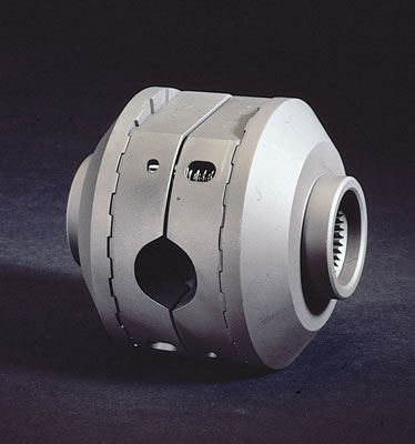

This is the Lockright: It can be had much cheeper from other places.
http://store.summitracing.com/partdetail.asp?autofilter=1&part=PWT%2D1920%2DLR&N=305029+115&autoview=sku
EDIT: Jeg's has it for $230
And I recomend getting the hardened cross shaft so that it doesn't wear into it and could play in the rear end

Lockright and No-Slip ARE lockers . Bot will positively lock up the axles . They both work the exact same way , ones is just quieter .
They work by using the surface of the ground , and the center pin beween the shafts . When you apply power to the driveshaft and it starts turning the ring gear , the center pin wedges into the couplers of said locker pushing the couplers into the drivers ( side gears ) .
For turning , the tires on the ground are turning different speeds , and the locker is able to relax a little and let the teeth of the couplers and drivers overun each other . Producing a nice click noise in the Lockright and total quiet in the NoSlip .
Its really cool and cheap . Check it out by googling Lockright :thumb:
