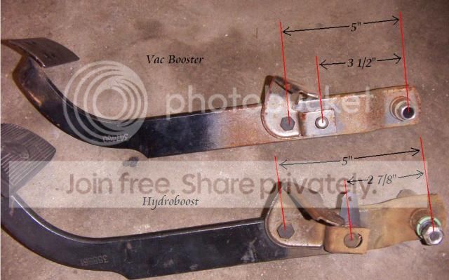

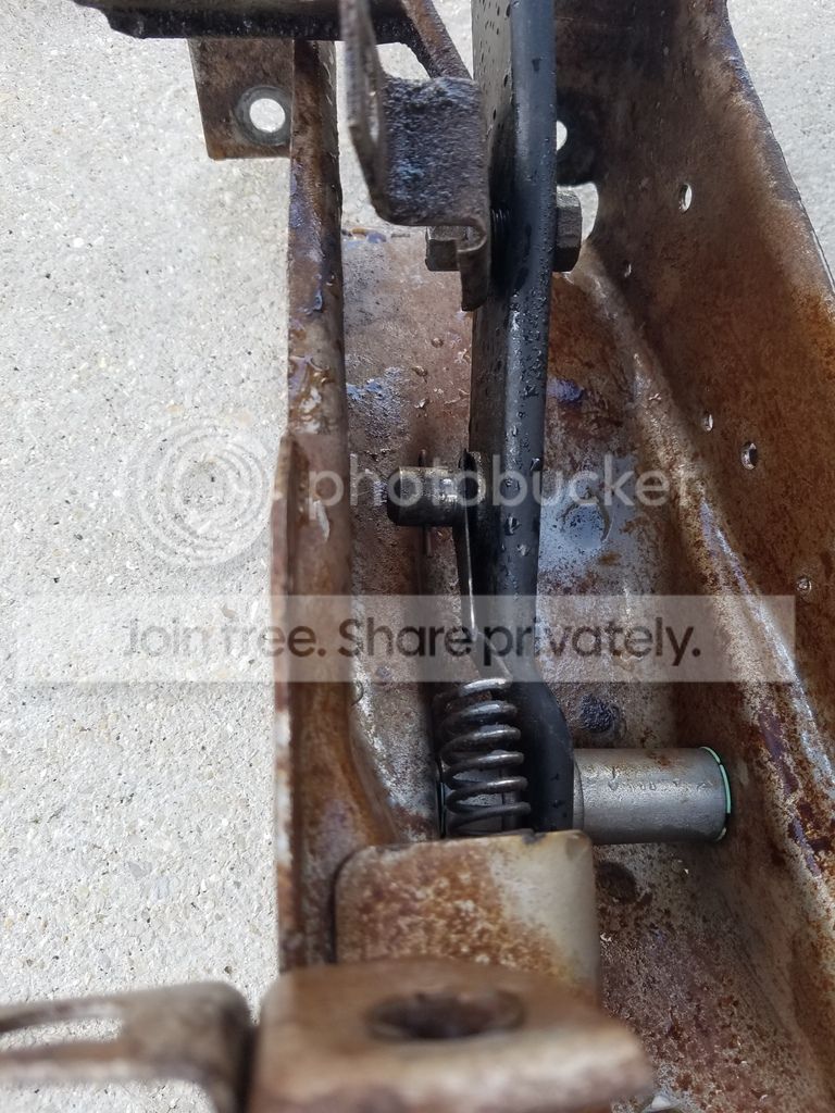

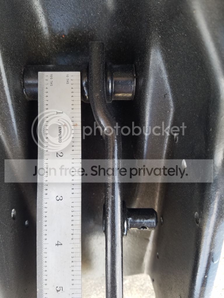

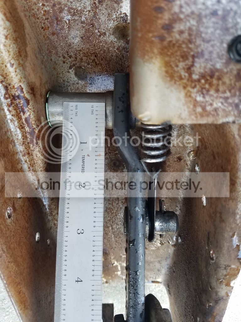

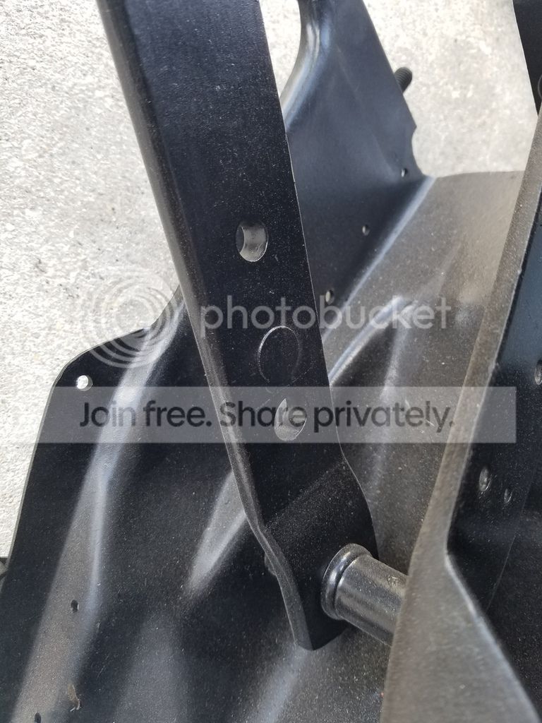

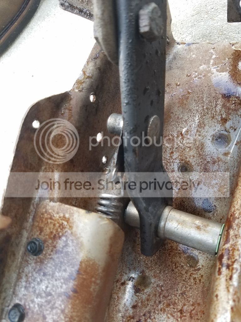

The pin location for the brake pedal is in a different location on each of these sets. I thought they were both hydroboost. Nice clean painted set has two holes. Can not confirm origin of either of these sets. Please confirm if you can. It seems to be tough to find the side by side differences online. Thanks
second set
Thank you for the link and clarifying photo. I did not at all look in the brake threads... noob mistake.
