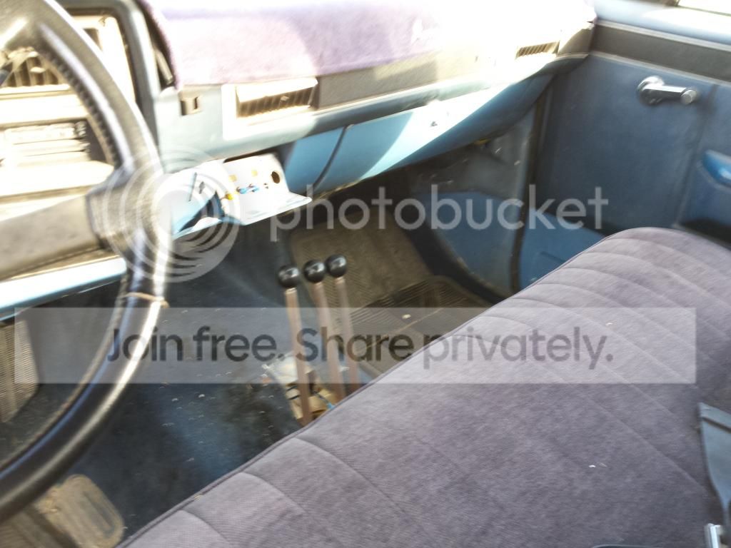

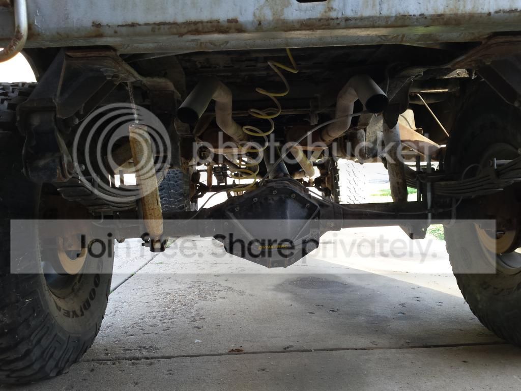

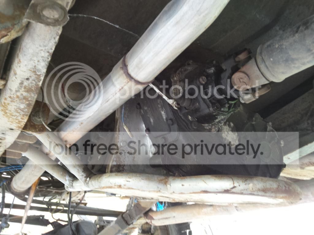

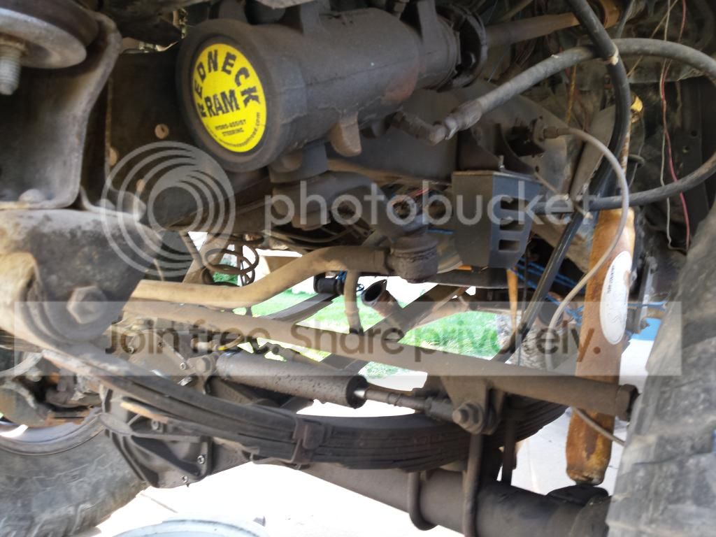

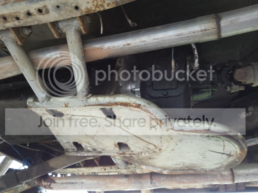

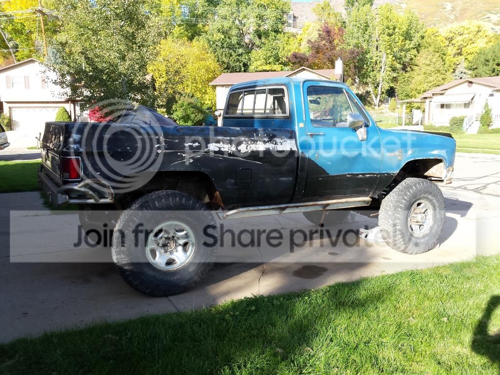

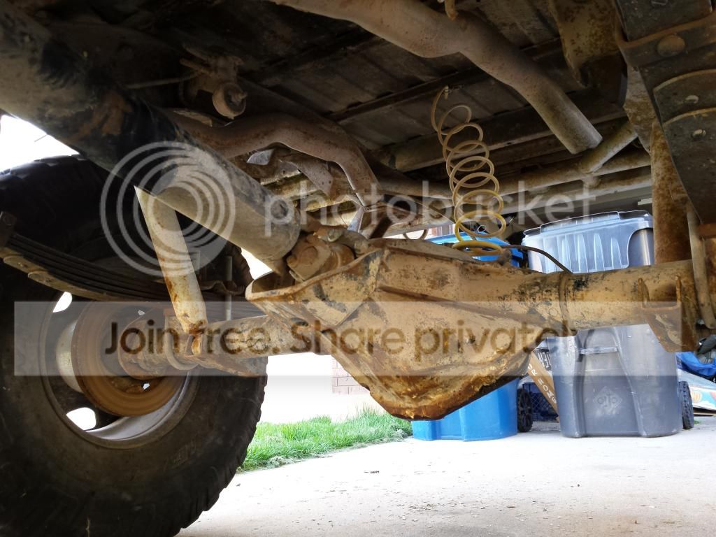

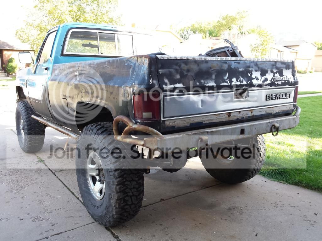

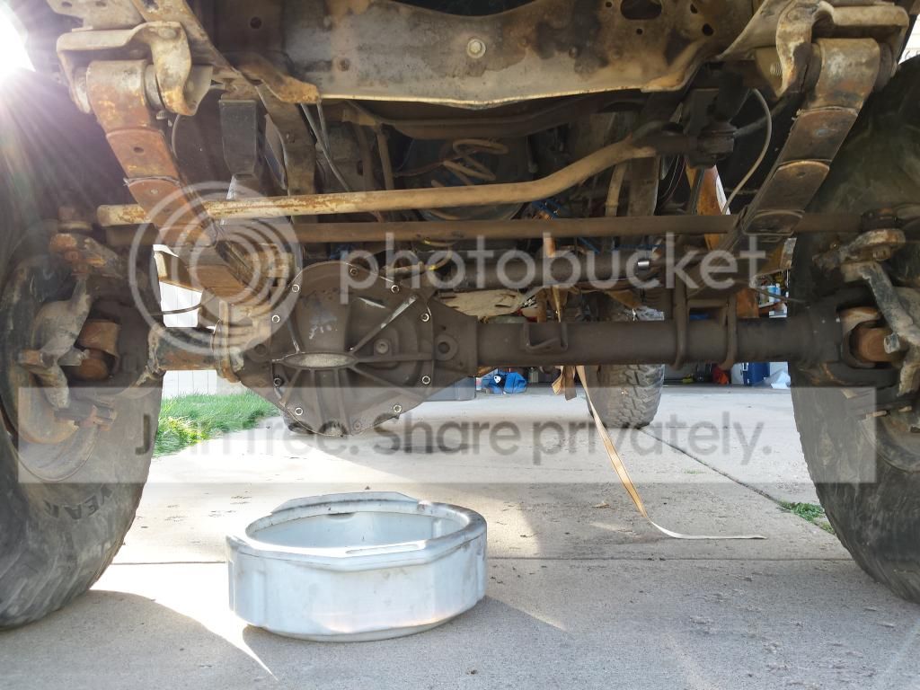

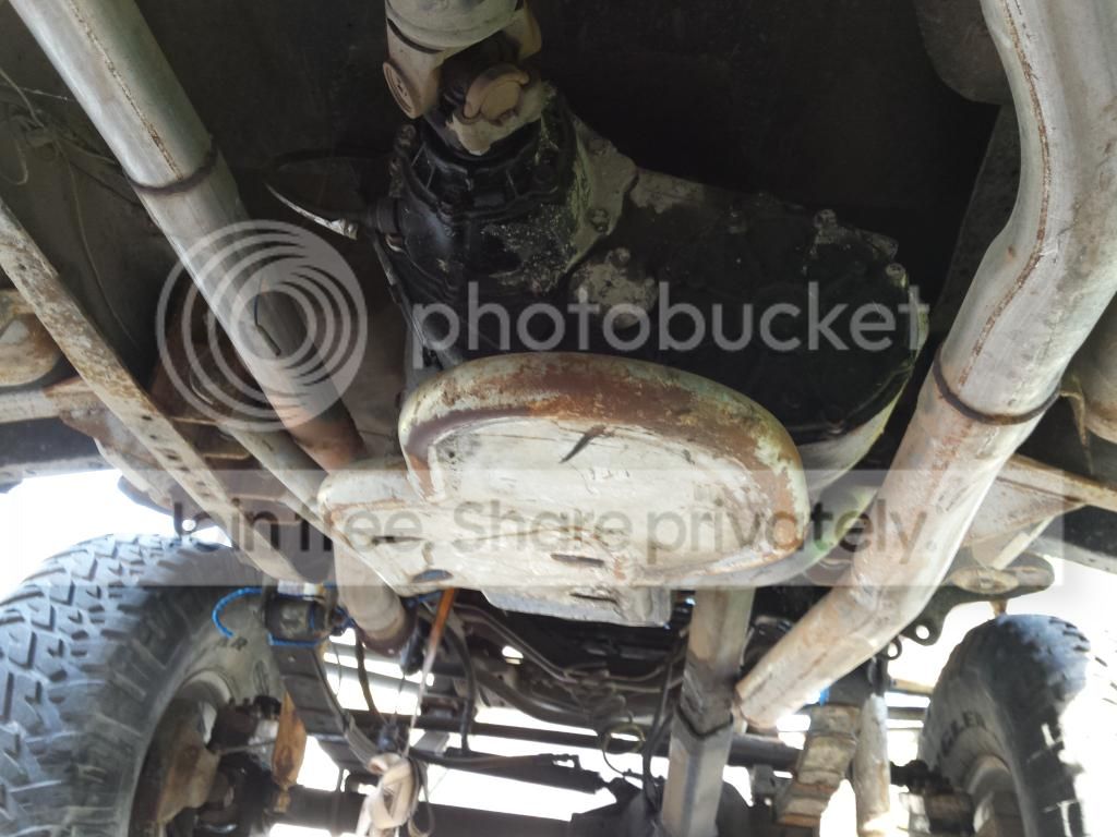

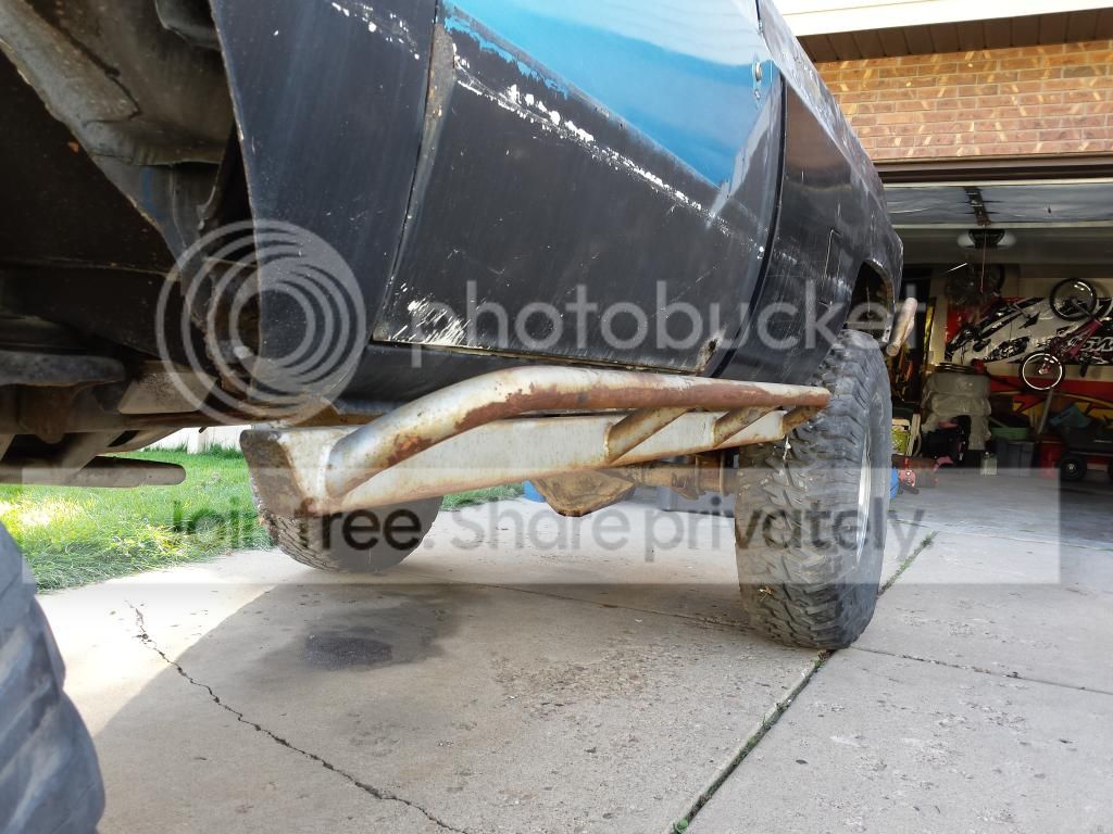

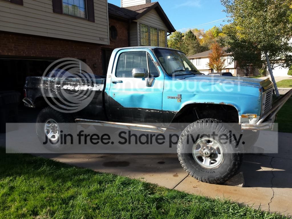

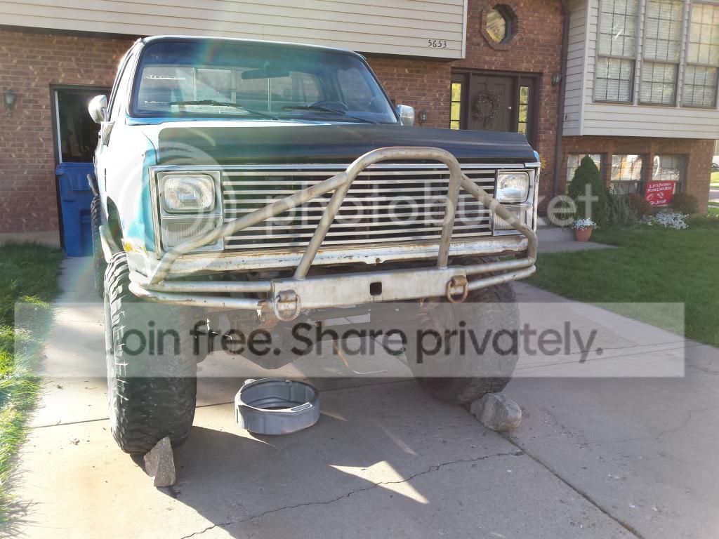

I have been searching for a long time and got lucky. I need to go through everything cause it's been sitting for 2 1/2 years so it leaks. I just found out yesterday that the rear brakes have a line lock installed and the 205 was modified to do front digs. Here are the pics finally.
I'm going to be putting everything on the white K5 but the sliders. I may cut the tubes off of them and weld them to the set I put on the K5. I can't wait to get working on them but I'm having some serious back issues so it may be on hold for a little while.
Awesome looking! Great find. Man, even has Dig. Is that an ARB in the rear? Did this person forget what they paid for it?! ;)
I wish but it has a Detroit. The coiled line is the breather.

I had a question about the 205 support. I have seen where people have added extra support on either the two holes on the passenger side to the frame or on the PTO cover. Should I add one of those as well?

I like the other stuff you didn't mention, the rear bumper (front sticks out a bit for me) and the sliders, and the skid plate underneath. Nice score.
