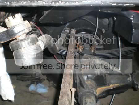

I wanna move my axle forward with a zero rate and I have crossover high steer. When I move my axle forward, is it going to make my tie rod and draglink want to hit? Here's a pic.
If you go to a ford van pitman arm and get it reamed for the larger DRE than you shouldnt have a problem. The arm is shorter and has less drop.
