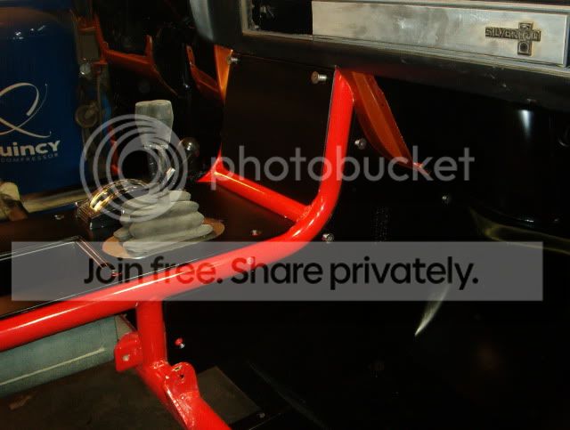

I'm getting started on a poop pipe cage with only a harbor freight bender this week :pimp:

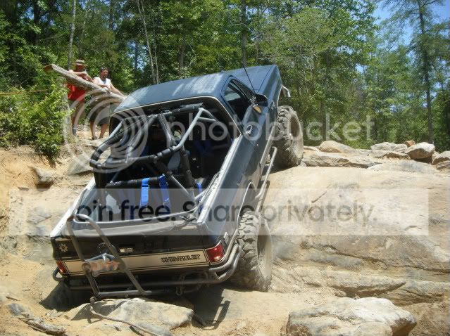

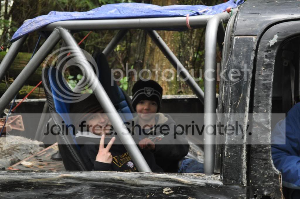

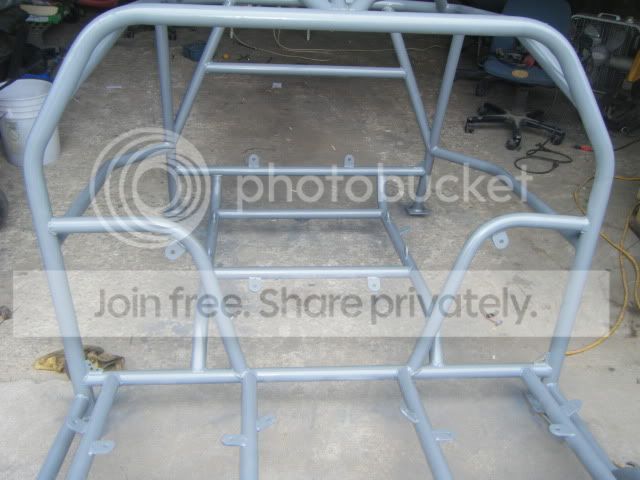

Here is mine. Its just from the B pillar back. Built it last year mainly so my kids could start going wheeling with me again. I built it with a rear taper in mind, and planned to do a full top conversion when I did the front. I may do a boatside as well when I do this so currently trying to sell it to a guy in the local club as I am not sure it will work with my next plan. I would also like to make the rear halo a bit larger as it came out a bit cramped in the rear. It is sandwiched to the body at the B pillar in two places and to the frame on the main B pillar tube. The rear kicker tubes also sandwich the body and go to the frame. Its all 1.75" HREW
You're gonna die...:D

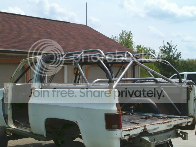

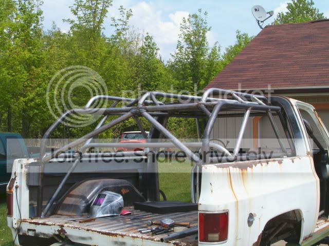

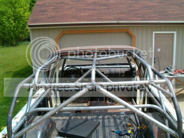

Here's my poop pipe cage built with a harbor freight bender...:waytogo:
It's tied into the frame in several spots from the front to the back...
I'm not going to make any bends sharper than 25* when I make mine

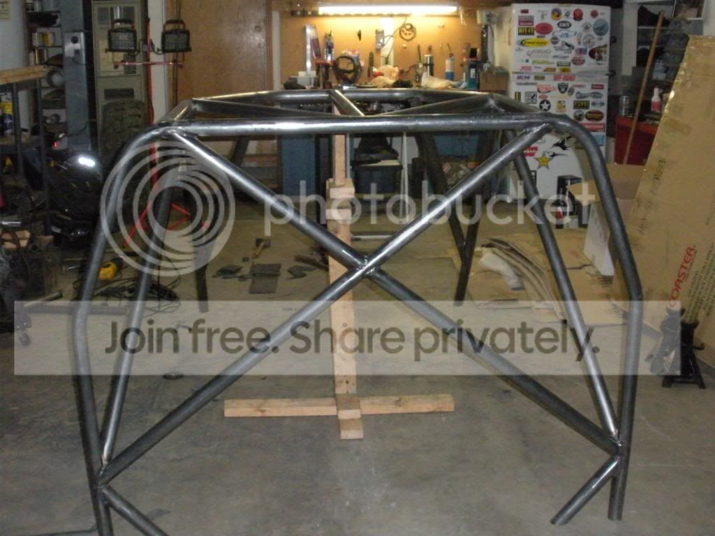

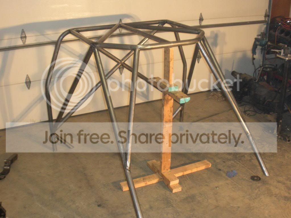

I just bought 60', I hope its enough to get the basic structure done, I'm going to use lighter tubes for triangulation and bracing.
I only want to do the A,B,C pillars and halo with it
Yeah I've done one cage before, but it was in a car. I imagine my burban will eat it up pretty fast
It's 1.9 .145 wall, so I didn't want to use a ton, maybe I'll get 40 more feet though
I guess it's not that much heavier if at all compared to 2" .120 wall. So maybe it's not a big to use 100' of it
It was 50 bucks for a 20 something foot length.

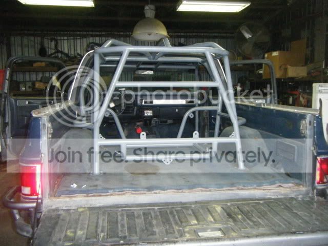

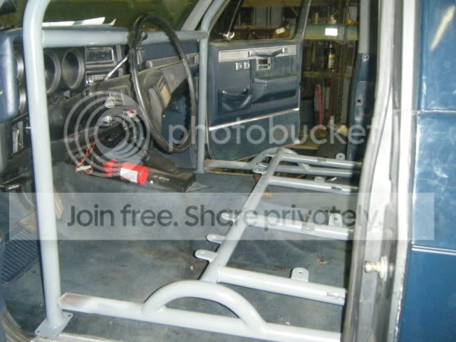

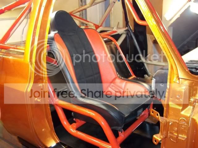

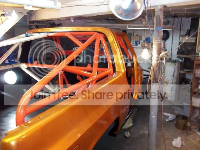

Tied to the frame at A anc C, but just sandwiched the floor at the b pillar. It is going to take some creative work to tie to the frame there.

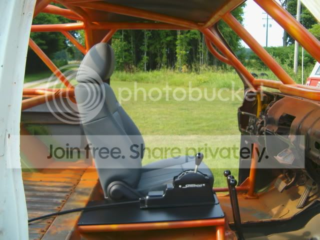

do you have some more pics of the front and back seats in the cage? I'm digging this
I made a 90* piece that attaches to the lower plate and goes right in front of the rear spring hangar to the frame I believe.
I have also seen people run a straight piece from the slider to the frame and tie the B pillar to that.

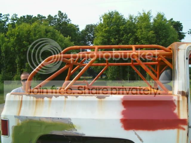

Oh and Howdiy IIRC I used around 50' for the rear section I posted above.

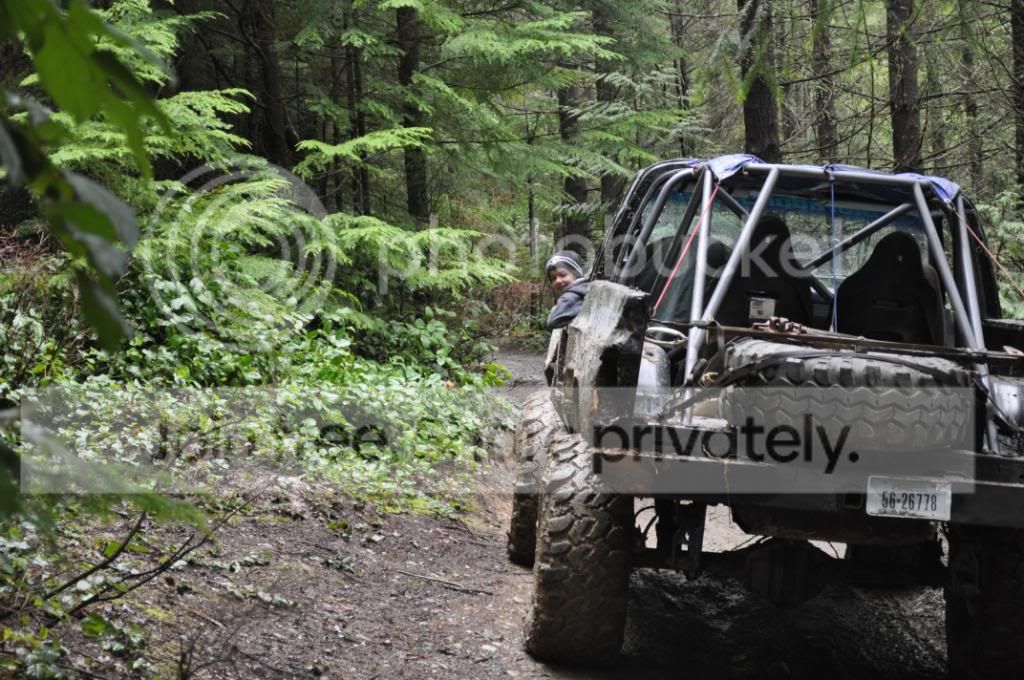

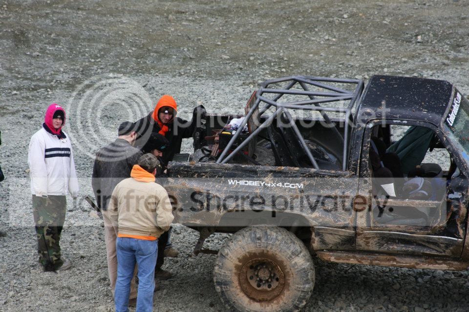

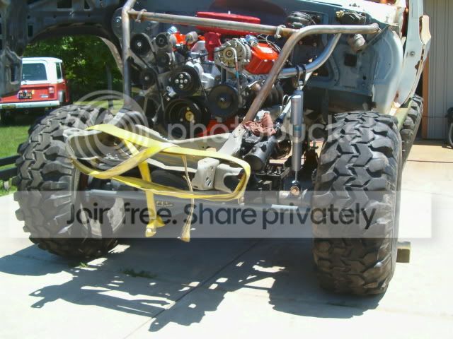

Tied to my sliders at A&B pillars. Tied to the frame in the front and C pillar.
Sliders tied to frame.
Need to get a better picture and get all the sheet metal panels back on.
