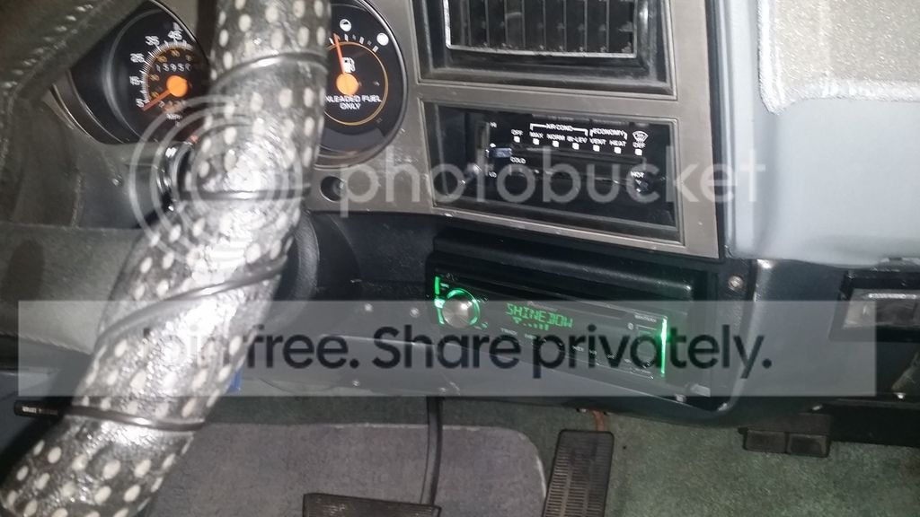

So far, 5.3L vortec, 01 Silverado Bucket seats, Tuffy Security console loaded with CB, 12v, USB and DC to AC inverter. Good Kenwood deck with Bluetooth for phone and music streaming. Soon to be added aux battery with isolation for winch and future camping power needs. Will also be adding a 12v onboard air compressor to the mix with at least a couple of gallons of air storage for faster tire fill ups when getting off the trail.

Bluetooth head unit with all new speakers. USB ports in the ashtray. Also got a 100 sq/ft of fat mat sound deadener.
