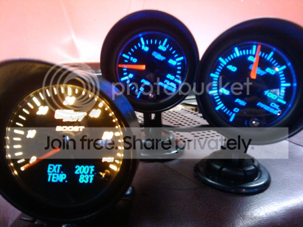

With a stock TBI in tank pump pushing to a mechanical pump on the engine, I'm getting 7-9 psi currently. (Middle gauge in pic below) I will tell you that an external may not have a problem sucking through a dead pump at idle, but as soon as you take off it's going to hate you and not run worth a ****.
