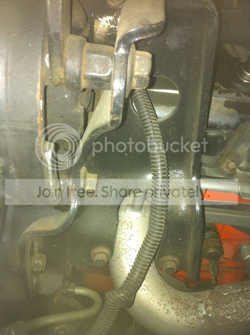

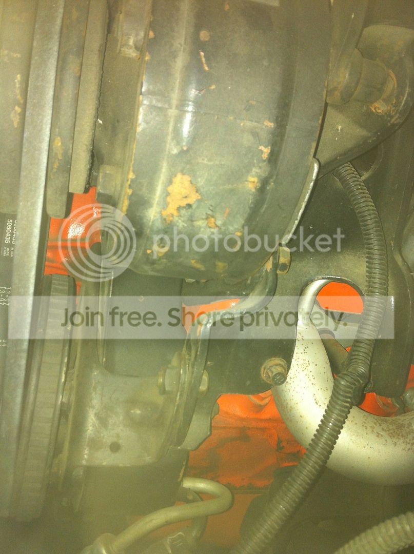

I am in the process of fixing power sterring leaks. Got the pump and lines removed. Noticed a bracket that looks broke or cut for some reason. What is this ear for, what bolts to it (ac pump I would guess), and I guess junk yards the only place to find one?????
Thanks
I think That part of the bracket use to be bolted to the exhaust manifold first bolt. It had a bracket to bolt to the compressor bracket.
you have it basically set up right. the broken bracket is sandwiched between the bracket that mounts to the exhaust manifold and the a/c compressor. you might get by with a thick washer if you can't find a good used bracket. broken one's seem common - i've had to replace a couple of them along with busted bolts.
yeah the washers worked. Would still like to get it fixed. I found some rr4 mount kits on ebay but the bracket i need looks different. just have to see how washers hold up.
