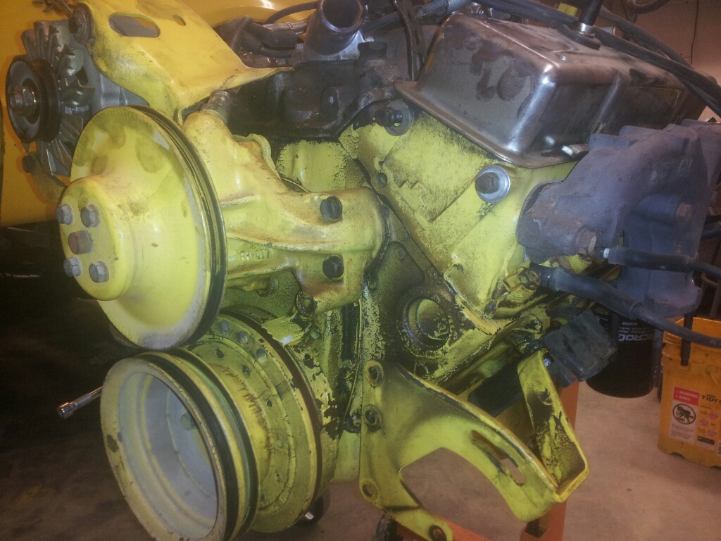

I'm thinking about trying to find a different power steering pump bracket. here is my current bracket:
The bolt that attaches to the motor mount is impossible to remove/tighten while the engine is installed so I'm wondering if there is a different style bracket that would work and if so, what year truck should I be looking for?
