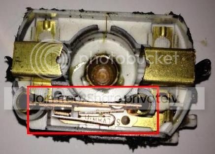

Something is binding causing the motor to overheat. On the inside of the motor there are contacts that will separate when there is too much current going through them. Once they cool down they will make contact again. What you need to do is find out what is causing the binding, either old weatherstripping, old tar-like grease in the channels where the nylon rollers go, old grease in the gears where the motor mounts to, or it could be old grease in the motor itself (which you can disassemble and refurbish if you wish to spend an hour or so).
Here are the contacts inside the motor I was talking about:
So just old great can stop it. The weather stripping is definately not awesome but does not appear to be binding at all.
How soon would those contacts close again? It does the exact same thing all the way up and the exact same thing all the way down
The old grease no longer resembles grease, it's all dried up and will stop parts from moving. I don't know how long it takes for the contacts to cool down. What you can do is when the window stops moving just keep the switch engaged and wait for them to make contact again. You won't hurt the motor since no current will be going through it.
