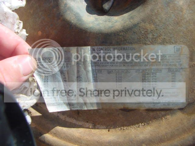

I got my distributor put back in and now at least the motor runs... but I need to get a timing light and set the timing... So I looked at the emmissions sticker, and the timing part is pretty much ripped off.. I MIGHT have made out an 8* BTDC... but I'm not sure.. So what should the timing be set at?? I still have a hard time understanding how the timing light works :o
And also, on the sticker it said at the bottom REQUIRES 91 OCTANE or better.. Holy crap.. is this true? I've used regular 87 for the time I've had the truck, and I'm pretty sure the Po's used it for the last 15 years!! I haven't noticed any knocking (detonation) but I'm certainly no expert and might not know what to look for.. So is it true that I must use premium fuel in this beast!!?? WTF :confused:

here's what the old sticker looked like :crazy:
8's about right for a stock 350. Thats what my sticker on my old '79 said.
Ideally, you want just as much advance as you can get without pinging.
Also, if you wanna run lower grade fuel, run it, if you get pinging, you can retard the timing a few degrees and be fine, or you can run higher octane fuel. With older non-computer engines you can get away with lower grade fuel by backing some timing out of it. At todays prices, run 87 and run 8 -10 degrees if it doesn't ping. Also don't forget about your mechanical advance curve - 8 is just your static timing.

10 deg. is more apt to ping than 8 deg. Dont let your brain melt, find books, magazines and search the internet. Better yet make a new friend in your area who can help you. Most gear heads are happy to help.
