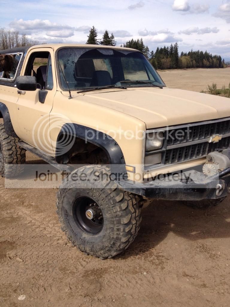

Hey, I'm from BC up in Canada. In 2011 I picked up my second 1983 K5 Blazer. As a kid, I always wanted to drive a lifted blazer. When I first got one back in 2006, I had big plans to beef it up, but my plans were cut short when my truck was stolen. It never got recovered. Only had it for a year. Fast forward to 2011. I pick up a pretty nice Blazer.
While my first one was mostly stock, I wanted to make sure my second would come with most of the upgrades that I wanted so to make up for lost time, and my garage situation was not there yet. My 83' came with ff 14 bolt and dana 60 combo with detroit lockers, I was set on having one ton axles. The body was painted with what looked like liner up to the bottom of the doors, which was painted the color of the body, which was tan. There was no rust on the body that was visible except in the tailpan. The floors were redone with 1/8" sheet metal in the back. The engine had been redone in 2008 by a local performance shop and was strong. dual battery, offroad lights, checkerplate side panels, shock hoops, 56" spring swap, crossover hydraulic steering. 6" diy4x shackle flip, 3" body lift, 38.5 tsl uper swamper sx with a spare tire on custom rear bumper tire carrier paired with a custom bumper in the front with a 12000 lb warn winch. 700 r4 transmission with a np 208 transfer case. rear disc brake conversion, heavy duty rock sliders, differential armor, skid plate, bushwhacker fender flares, a custom soft top. and it came with 4 big rubbermaids filled with spare parts, u-joints, fuel n oil filters, extra bushwhacker fender flares. So many times I would break something like a belt, u-joint, or light and I'd find it in those rubbermaids. I was recently digging through one and i was baffled I never noticed that there was spare stainless braided brake line.

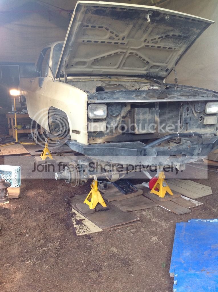

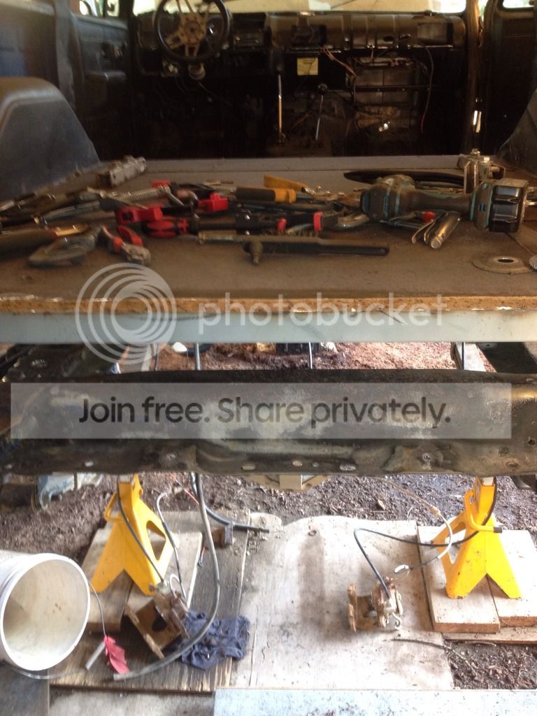

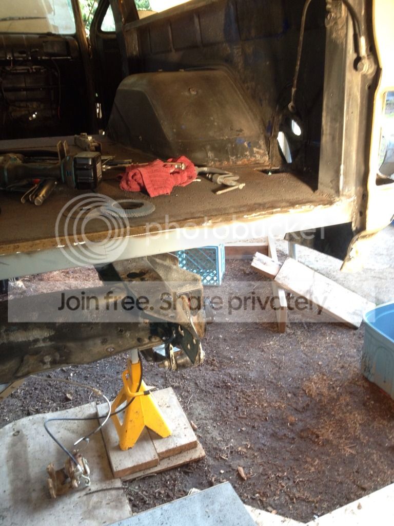

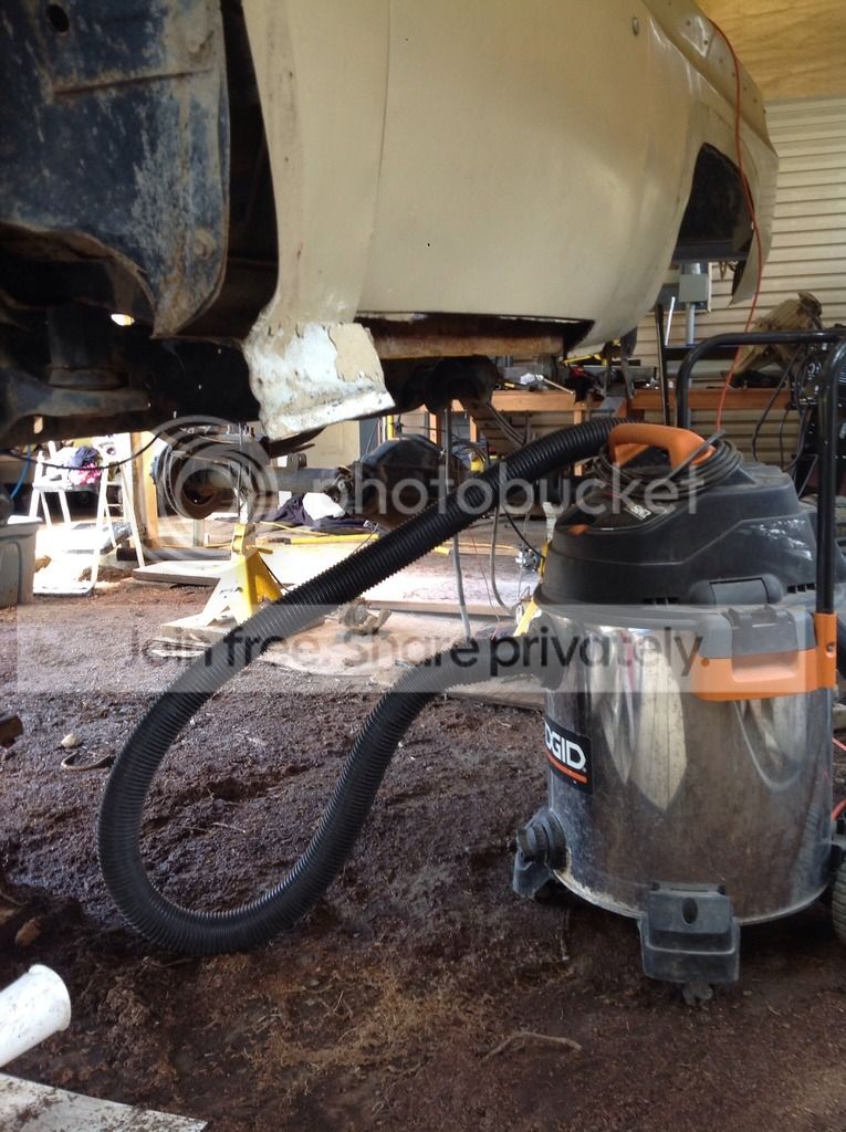

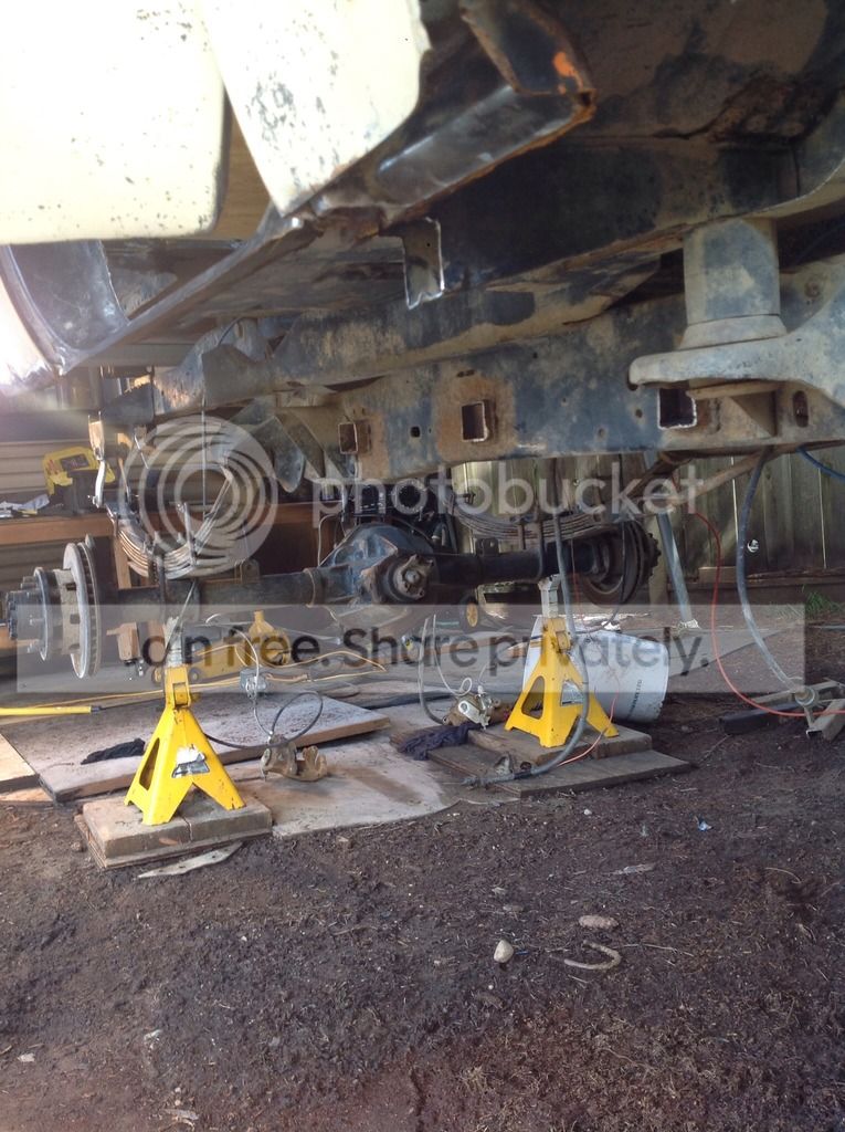

Right now my truck os stripped down to just body frame transmission and engine bay. I've exposed the belly of the beast, and it's time to sand clean weld and paint.

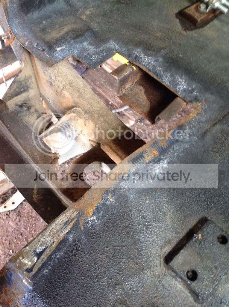

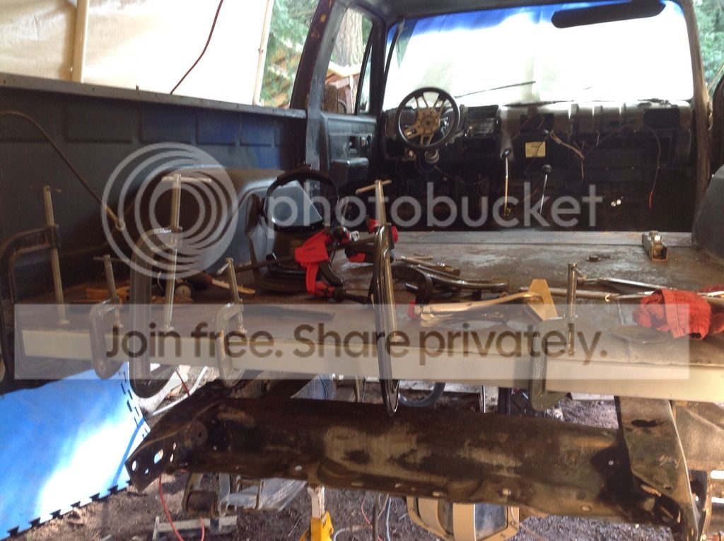

I have a number three body mount and both number five body mounts to fix. My rocker panels were filled up completely with mud and rust scale, so I cut into them. I'm going to replace them with 2x6 square tubing fender to fender. I ripped out the tailpan, and to supplement the tailpan and the body mounts at once I also used 2x6 to reach the bolt holes one the frame and body. I capped and notched out the front corners 2" so it's sealed and the real taillight wires can fit through. I'm in way over my head, seeing that this is my second time welding something, but I like the challenge and I'm pretty sure I will be able to weld by the end of all this.
anyways here's some pics of where I'm at.

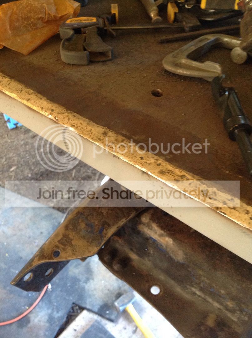

Finished the front seam on the 2x6 tail pan. Switched from no gas to gas halfway and it made a huge difference. This tailpan should be significantly stronger now. Next will be body mount number three and the rockers.

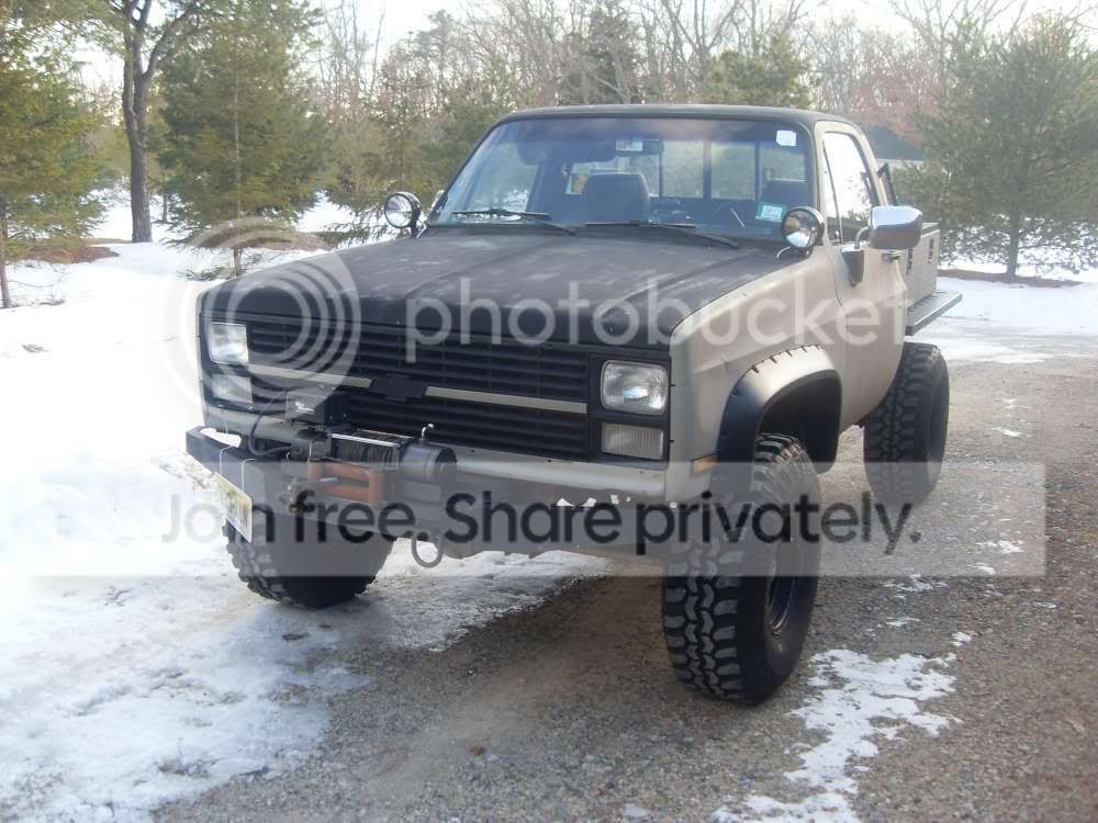

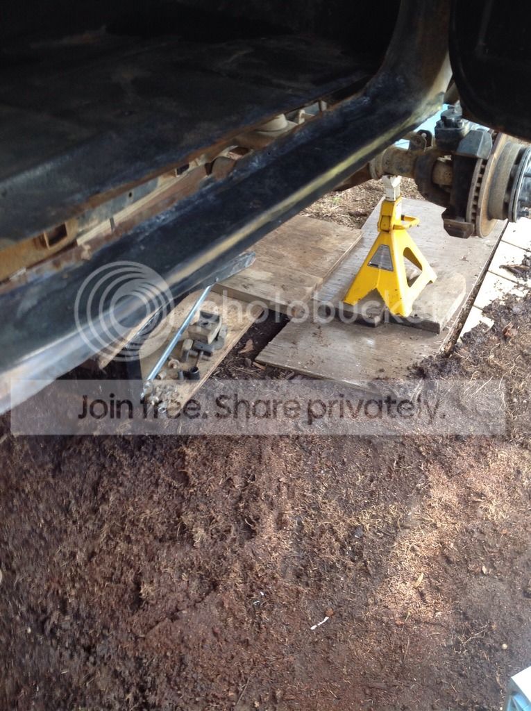

It was custom made by a guy here in BC and put on by the previous owner. I found numerous threads the previous owner made about the building of the truck onbc4x4.com. He made custom front and rear bumpers, rock sliders, and a spring swap in the front. They're heavy bastards. I cut off the rock sliders. They were made of 1/4" steel and they were starting droop after years of bouncing up and down. They were un even and about to start to warp the frame. Plus, when I drop the body mount they will interfere with the rocker panels. The new rock sliders I'm putting in are inspired by the member Ryoken's k5 build, but probably won't be as nice.
Been struggling to get time in on the K5. I just had my second little girl on April 14th, and juggling two kids with a post c section wife is definitely time consuming. I can't complain though as I'm a proud father once again and it's been a joy welcoming my second daughter to the world.
I was able to get some quality time in today on the passenger side rocker/rock slider upgrade. Got all my steel painted with weld thru primer, and my body mounts in position to where I want them. Then I welded them up the best I could.
