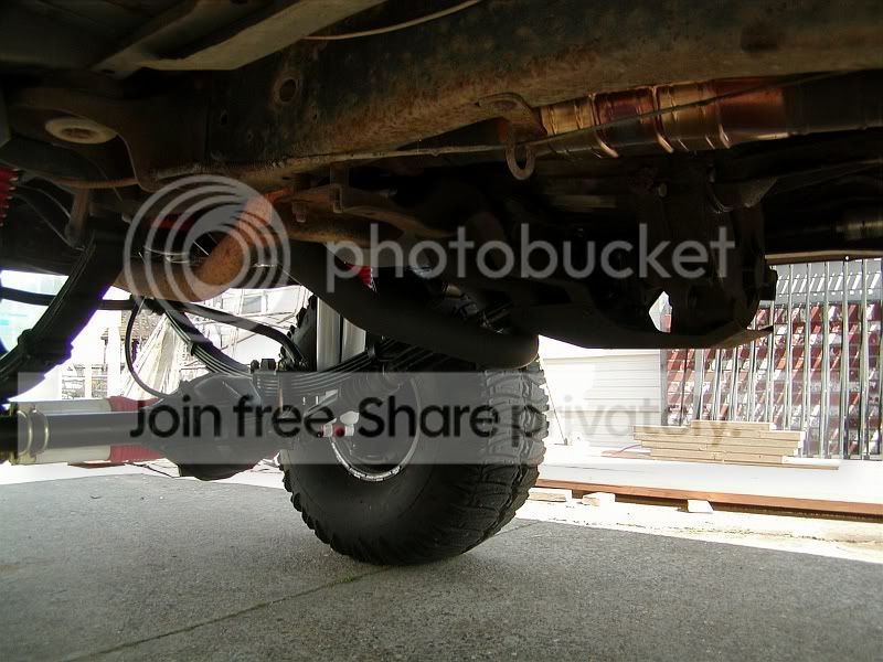

PRoblem with 1977 blazer help please
I don't see what the problem is. I hope you weren't expecting stock angles after adding a 6" lift kit. :rolleyes:
That's about right. I've had my "77" for 12 years. I've gone from 4'' to 6'' lift an had the same thought, wait till you flex it real hard with the right tire in a deep hole an that drops down an back. Concider splitting the transfercase with a twin stick. It takes alot of stress off the front shaft an still have it in four low. best of luck...
UPdated reply
So the angle of it is not a problem people where telling me i would be snapping u joint left and right
It doesn't look like it, and it shouldn't. I've got a 12" lift and my U-joints are doing perfectly fine.
