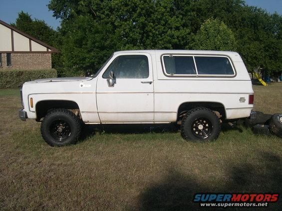

    Well I got the springs on, axles in tires on it. Still need to finish the brakes front and rear, hook up the driveshafts and my steering arm came in today so I gotta put that on.
    Before
    [​IMG]
    After: (crappy pic camera acting up
    [​IMG]
    Tires look REAL small they are 36" military tires but barely measure 35". The 36" IROKS will fill out the wells much better will post better pics when camera stops screwing up.

    looks good. the 36 iroks measure out to 37s. what axles and gears you running?

    yeah that is why I want the 36" IROKS they measure 36.8 dang near an actual 37" tire. They military tires look real small with the lift on but hey just gives room for articulation right now the IROKS will look a lot better I think.
    I am got a 3/4 ton (8 lug) 10bolt and 14boltSF with 4:10's out of an 81 K20. According to all the calculators I have looked at and used 4:10's return me to my stock ratio as far as the engine and RPM's etc. I guess 4:56's or 4:88's would be nice but this is a budget build and the 4:10's were already in the axle and should work pretty good along with saving me the money regear would cost. Engine has an upgraded cam as well for some more low end torque.

    Yeah I agree that is the only reason I was contemplating 35X14 Boggers. A picture from the side would show it better there is a lot of room with the tires on it now but not so much room that the tires look small..make sense?

    Absolutely. I think it looks good now, and if you take those meats off you'll have to give them to me. :p:
    I really like the way my tires fill up the wheel wells now, and considering the only problem I have with them is the fronts being able to contact the fender, I'd leave it.
