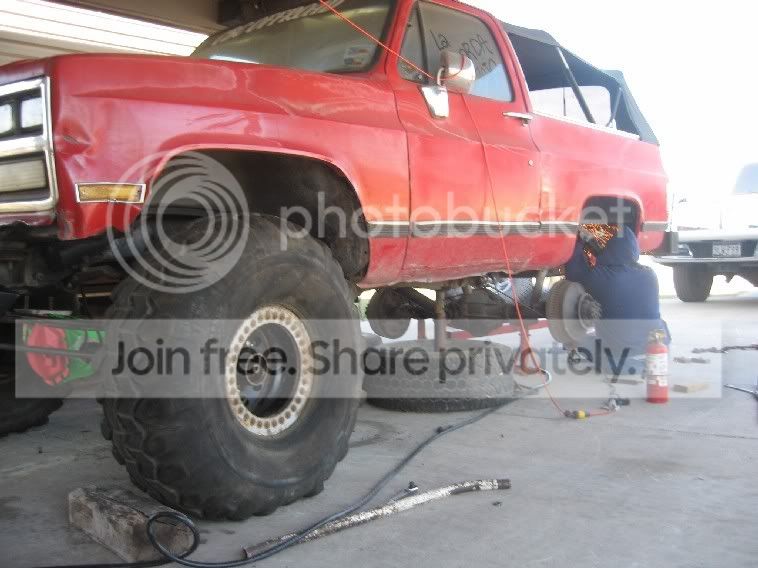

Here is how it looked when I started.
This is where I am at now. I already got the 60 in, and the 52's. I am moving on to the rear.
