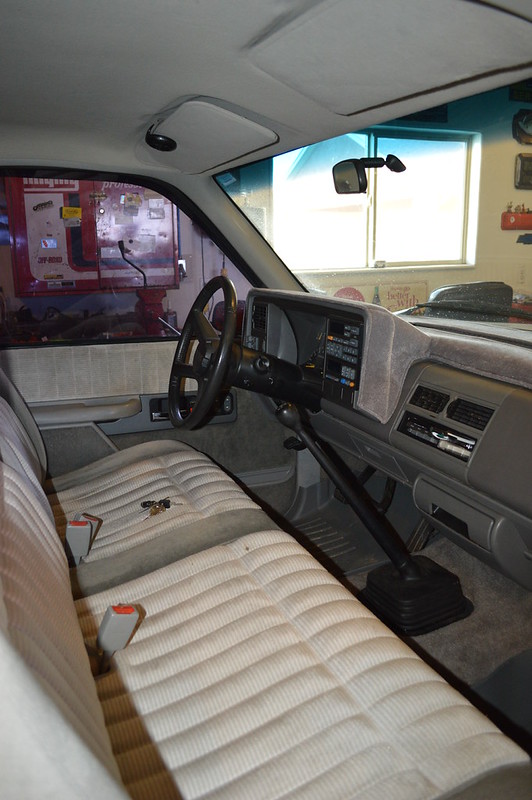

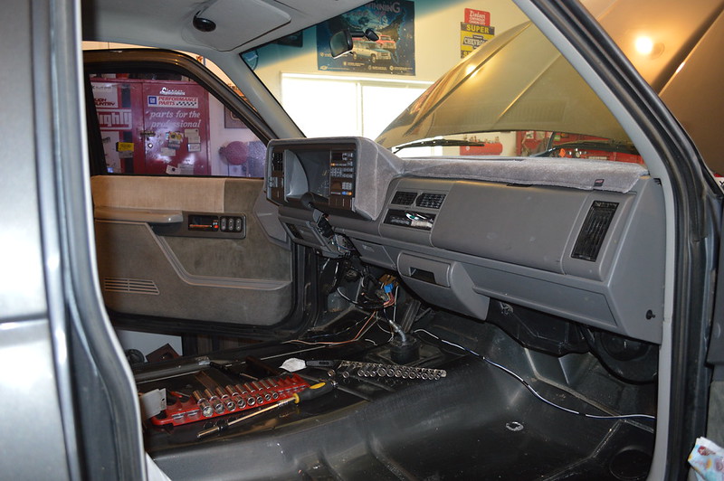

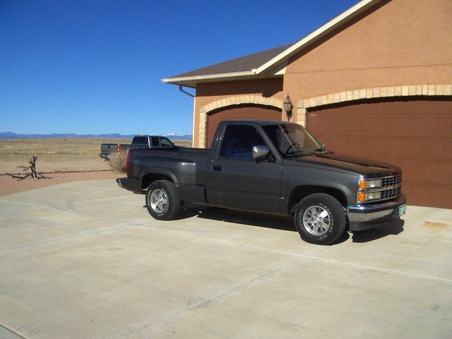

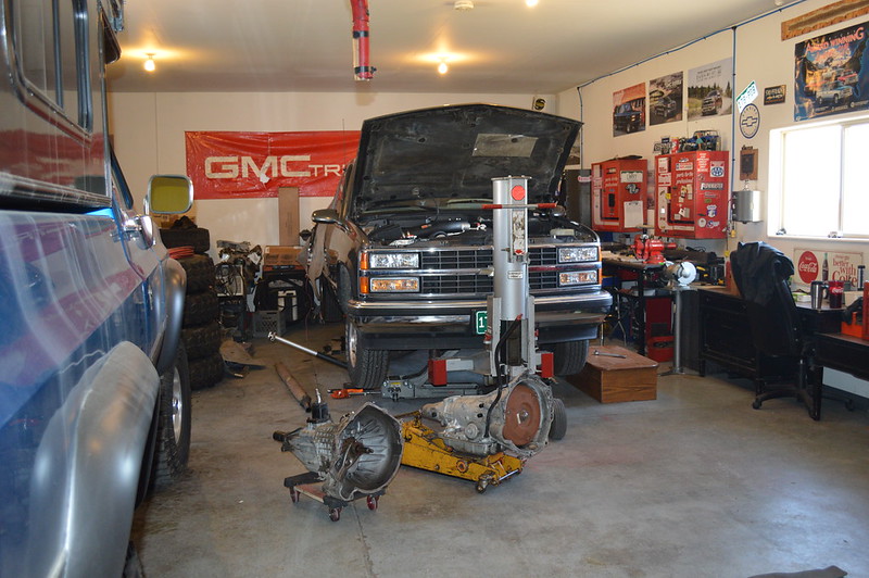

Check out my latest project. Been working out the bugs of a 4.3L to TBI 7.4L swap that I did last year in a C1500 Sportside for my FIL then swapped out a Getrag 5 speed to an automatic using the TCI EZ TCU kit over the past month. Between moving to an auto trans and finding a tuner that can actually make it run right it turned out real nice! I’m very impressed with the TCI kit. The old man was tired of rowing gears plus he already roasted the clutch I just put in there last winter.
Before
During
The poor K10 is filthy from just sitting for several months
Just a 4L60E behind a 7.4L but it was cheap. $450 for a 45,000 mile GM SERTA. 4L80E’s were stupid expensive. If this one shots craps then we’ll move to a 4L80E. The TCI kit will run both, 60s and 80s.

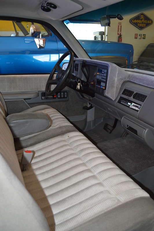

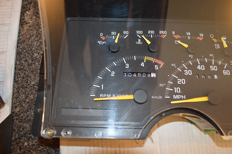

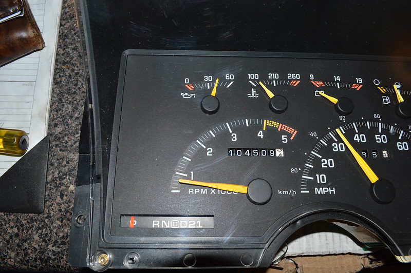

You would never know it was born a manual. I even added a PRNDL into the IP
It does one hell of a one tire fire burn out too! I need to take another GoPro video as I found the TPS voltage was only 3.9 volts after the test drive. I discovered the throttle cable wasn’t pulling the throttle plate open all the way. Installed a new cable and started getting a full 5 volts at WOT. She runs better now, will roast the tire into 3rd without even power braking :haha:
Its a sleeper all the way down to the OEM wheels and little 235 tires :haha:

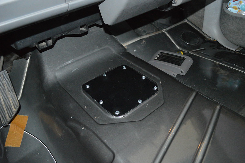

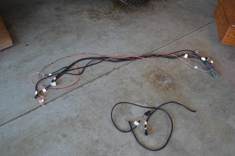

Although, I think TCI could do a little better with the fit and finish of their harness though. I ended up unlooming the entire harness to clean it up and unpin a few BS circuits I didn’t want to use like paddle shifter, manual torque converter lockup, and speedo motor ( that one is for running a speedo motor to run old cable operated speedos). I did retain their Performance circuit though and ran a switch below the dash. It basically works like the Tow/Haul mode on newer trucks. I had hoped to mount the TCU behind the glovebox but there just simply was not enough room so it ended up under the seat. The TPS, Tach signals to the TCU come right off the engine ECM rather than tapping in to wires under the hood. So, all the connections are inside the cab (other than the power and ground which TCI wants direct mounted to the battery) with the TCU mounted under the seat.

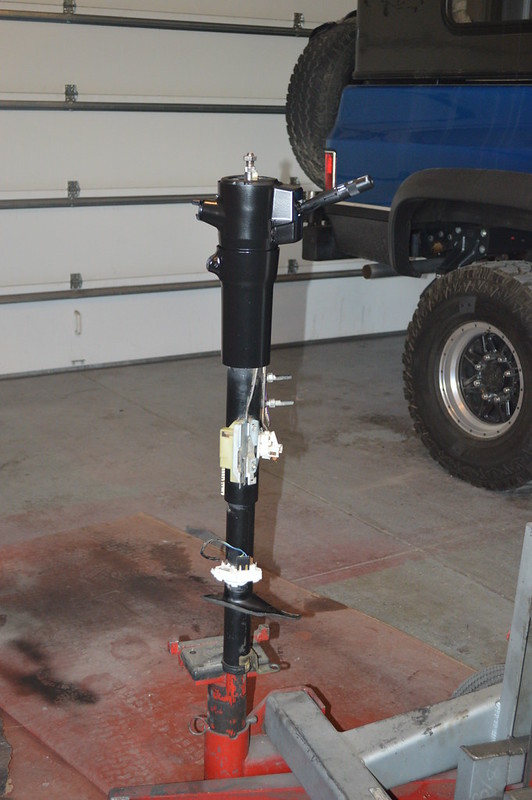

The biggest hassle of the entire job was locating an auto/tilt steering column. There were absolutely zero 88-94 GMT400 columns to be found anywhere near me and if you do find one it was busted open from an auto theft recovery. Eventually I found a derelict GMT400 sitting in a lot of a construction company and stopped to see if they would sell parts off of it. $50 later and I had a crusty column in hand. It was pretty rough as the truck had sat for a few years with the window down so I ended up rebuilding the whole thing. It got a new turn signal switch, multifunction switch, key cylinder, ignition switch, new shift lever pivot bushing and back up light switch as well as a coat of paint. Oh, and of course the typical 4 bolts that come loose on tilt columns was lock-tited and retorqued. The pedals and wiring were a piece of cake. The rear shaft had to be cut 3” along with adding a different yoke. It was a long process but not difficult. Got a lot of GMT400 manual trans stuff if someone needs any of it for swapping a manual into one.
After painting the column
This is the TCI harness after I clean it up and pruned off a few things

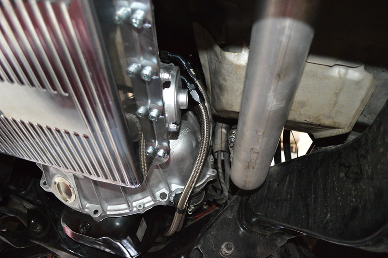

This sucked though. The exhaust was right in the way for the shifter linkage. I added a piece of flexpipe just to get it to the exhaust shop without shooting flames from under the truck. They only charged $50 to rebuild the complete LH pipe from where I cut it all the way to the back of the crossmember.

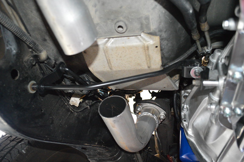

The temp pipe in order to drive it to the exhaust shop. Hey, it worked :haha:
