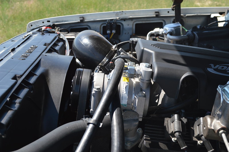

Based on this thread and Larry's guidance, I just swapped over to the big-block radiator setup (same as Larrys), ditching the aluminum 4row and electric fans & their shroud. I can now idle in 95F full-on Sunshine with the AC on and it hangs right at 180F. Before it would creep up to 210 and then I would have to cut the AC off (in stop/go traffic). Very pleased. Thanks Larry!

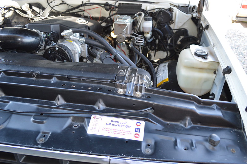

The shroud and hydroboost were picked out of the junkyard. The booster came off of about a 1985 or so 1 ton chassis cab. The shroud, upper radiator cover and radiator brackets came off of a mid 80’s C10 with a 6.2L diesel. As big-blue mentioned, 7.4L trucks and burbs should be the same. The brake master cylinder I went with was a Napa M2135 and the McMaster-Carr firewall plug is a 9600K527.

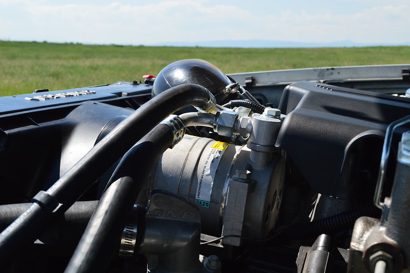

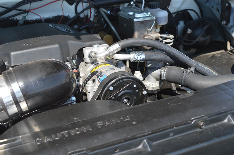

Oh, I finally got around to pumping up the A/C pumped this afternoon. She works great and that Delphi HT6 compressor is so quiet you don’t even hear it run. It’s in the upper 90’s here today and she was blowing 54 degrees out of the vents cruising down the highway. 54 really feels cold when it is almost a 100 ambient. Next 2 projects is to get it back to the tuner so they can straighten up their tune to take out the parking lot idling hop and the piss poor cold start open loop operation. After that it goes back to the exhaust shop to have some rework done on the exhaust as I cannot stand the way it sounds. Going to have a dual inlet dual outlet Magnaflow x-muffler installed and move to true dual exhaust instead of the huge restriction it has now where it is squeezed down to a single pipe for 3 feet.

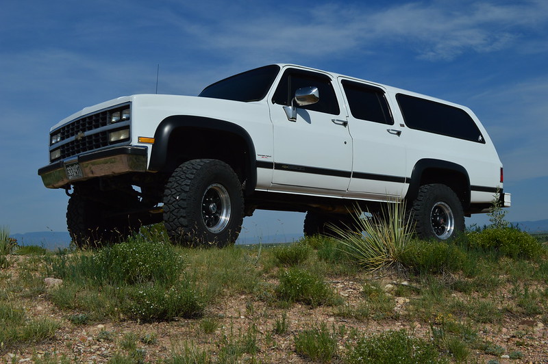

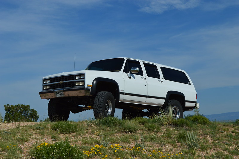

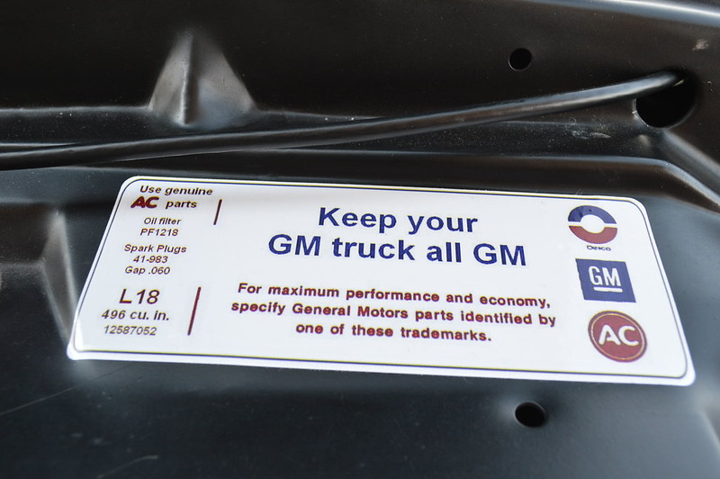

Oh, I forgot to post the official decal to consummate the 8.1L install :haha:
And a few shameless glamour shots :laugh:

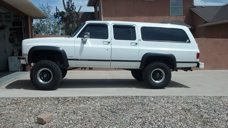

Couple updates on the ole girl. I ran it over to the exhaust shop a couple weeks ago to replace the restrictive single inlet/dual outlet Flowmaster with a dual inlet, dual outlet MagnaFlow. Turn out pretty nice and much quieter and less poppy. Still can’t say I am totally thrilled with the sound but it is certainly better. It sounds too much like a Camaro or Vette where I prefer the cackle of the K10 much more. Ah, well this will do for now.
The new dealeo
Before

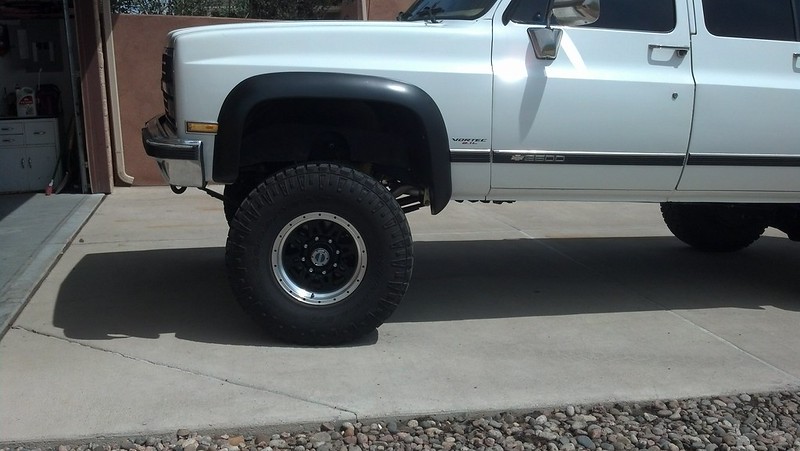

The more I’ve been driving this thing the more I notice how sucktastic the front springs are. It’s harsh! The lift springs were some el cheapo hand me down spring off the K10, maybe Rancho or Rough Country's. I really like the way the K10 rides with Superlift Softrides so I ordered up the exact same part number which is supposed to be a 6" spring. When the new springs arrived I thought they looked very odd and nothing like what is on the front of the K10 so I called Superlift where they said they changed suppliers over the past few years so the springs may look a bit different. Yeah, not only do they look different they are sky high! Superlift’s 6” 01-235-6 spring is more like an 8” lift spring. I called Summit Racing and they are shipping me a 01-234-6 4” spring set to replace these. They’re also paying the ride for these sky high springs to go back
Stupid tall!
