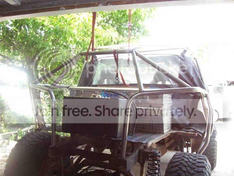

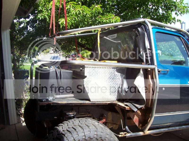

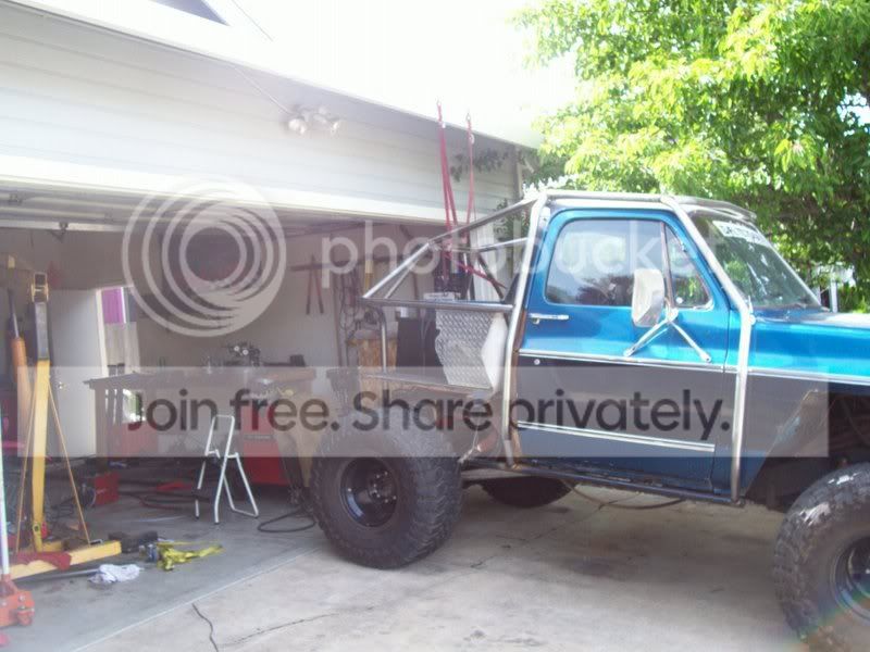

made some changes since i was around a while ago. Bobbed the bed of hte truck and started the exo cage this weekend. Check out hte progress so far...
much more to come :wink1:

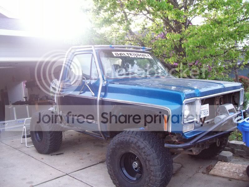

notm uch has changed on the blazer except i cut 28" out of the bed and added a fuel cell. Oh and now the taillights work! Still only have one dm headlight though :-/

that is one sweet exo cage. i love how it follows the body lines all the way up. perfecto man. i want one
the exo isn't even near being done in the rear, some more bracing and some aluminum are in the plans...

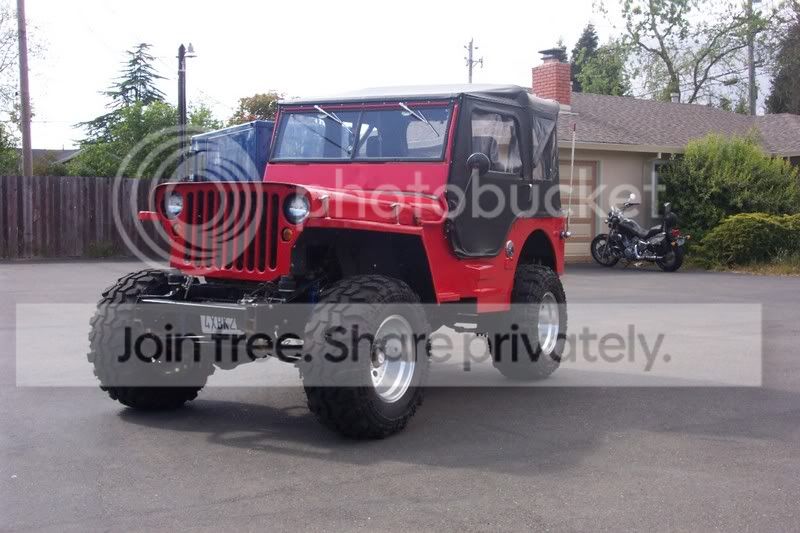

actually it's a gpw frame with an MB body on it. Used to have a turbocharged flathead four but it kept blowing head gaskets so we swapped in a buick v6. Going to redo the suspension with coils front and rear but it will be the same ride height as above plus maybe an inch. It's my girls and we are keeping it low key. Plan to lock the rear also but keep the front open. Probably throw on a 6000lbs winch and call 'er good.
Right now it has a full cage, repalcement seats for a new jeep, custom dash and consol, 31x13.5 swamper sx tires, camero power steering, dana 18 t-case with t-90 tranny, bucik v6, dana 41 rear and dana 25 front with cehvy disc brakes. oh and hte body mounts are air bags which sounds cool but is a bad idea, creates tons of body roll and didn't really help the ride.
