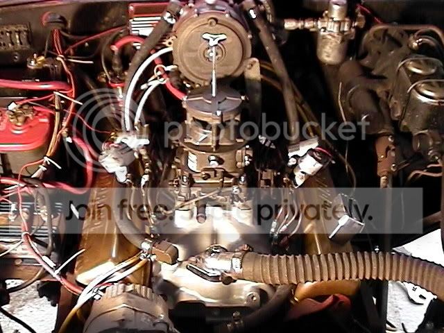

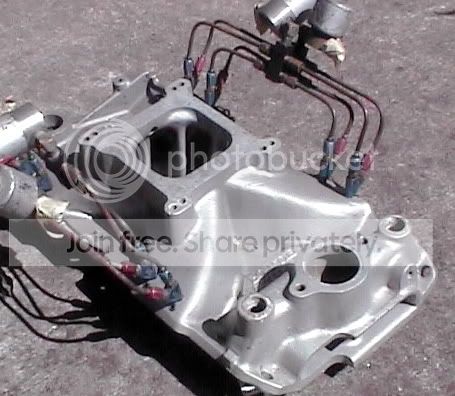

This is what I'm running in my buggy and will soon be swapped into my K5. 421 SBC with a single impco 425 mixer on a victor jr manifold with a pro-shot nos system. I add propane with the nos through the nozzels(5:1) using nitrous soleniods on both the fuel and nitrous. Using the 'pane, being a vapor(vaporizes as it leaves the nozzel), is much more compatable with the nitrous the liquid fuels. Being both vapors, close to the same temp, high octane, slower burn time, and a higher flash temp, it's like they are made for each other. I use a Mastermind box for timing changes and all the other cool adjustments it offers.

I really doubt you will have freezing issues in AZ. I have been figuring on running a block heater on the S10, mainly so the coolant passing through the vaporizer is warm at start up. If you are REALLY worried, wrap the line from the tank to the lock, and from the lock to the vaporizer. And run a block heater, don't worry about the vapor line from the vaporizer to the mixer. Thats my thought on it anyway.
