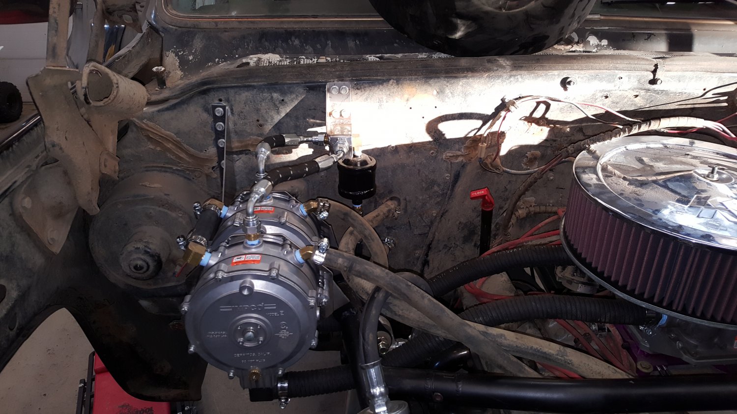

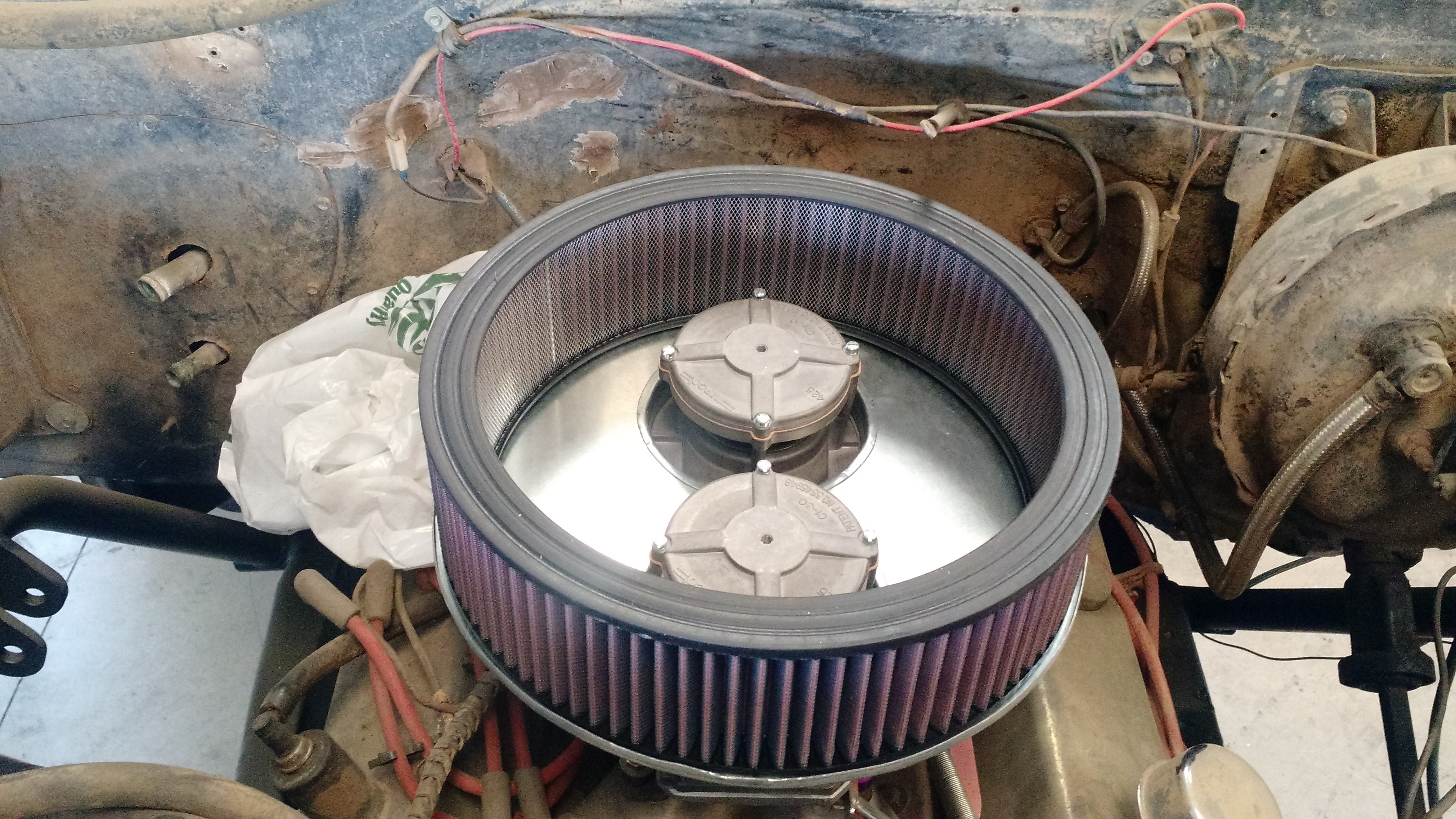

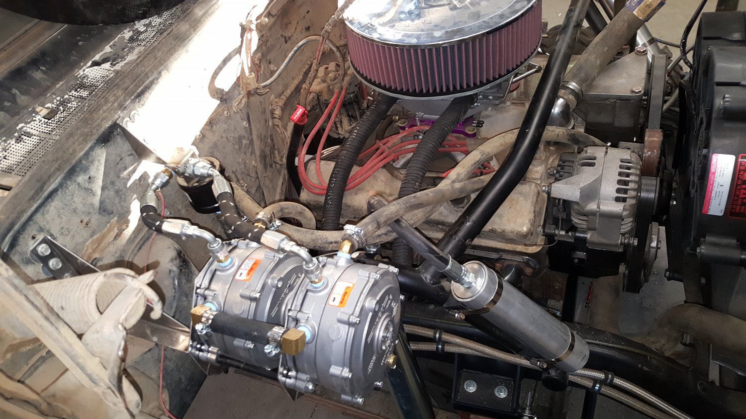

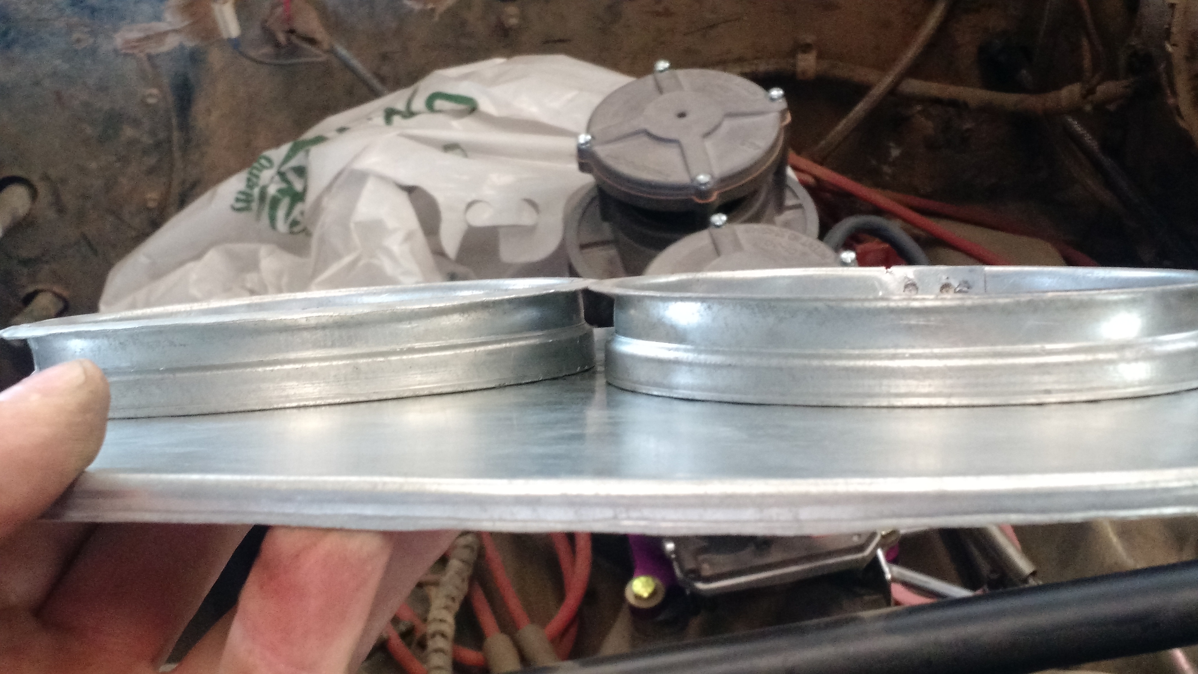

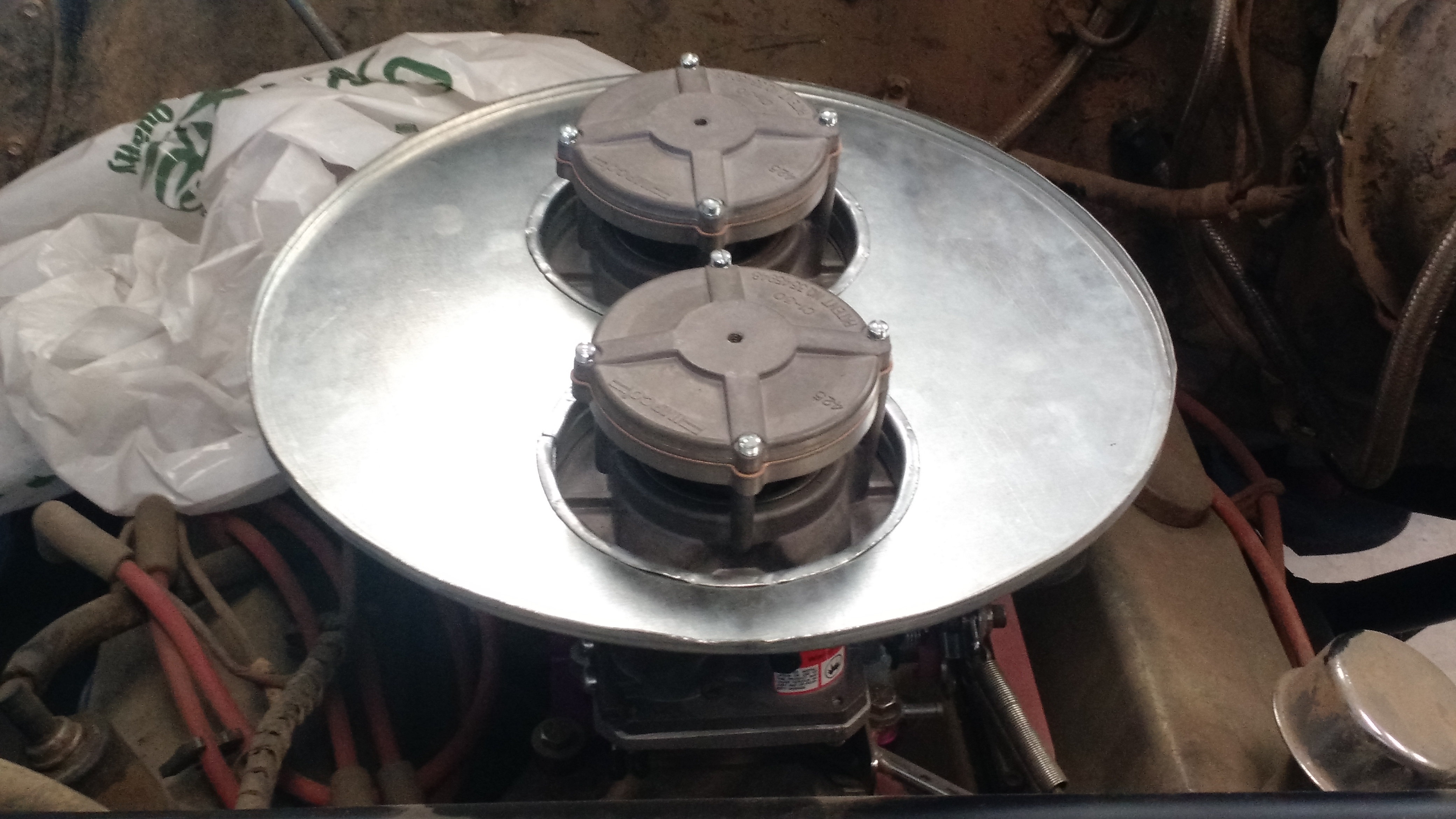

I don't have a build unfortunately, probably should some day. This truck is 5+ years in the making. I've got a lot of pictures in my media gallery. I'll attach a couple. The kit I have is the "high performance kit" from Got Propane its the dual carbs(mixers) with the adaptor like you have with one 850 base plate. Everything was new good quality. Cary was really good to deal with. The kit actually has everything that you see on his website. (you have to dig a little to find the picture on the site) The kit actually comes with more fuel line fittings than what you'd need, 90s,45s and straights. I made an air cleaner base and just used a standard 14" air cleaner also.

Broflow.....Should patch together some pics and do a thread... Nice job on the firewall mount, alot cleaner than mine. Also the air filter base looks real good, i paid 30.00 for mine. It doesn't have that nice lip for the filter on the bottom tho. (What i did to get this tuned in nice was buy a wideband afr gauge kit, comes with an 02 sensor and gauge. You can dial it in pretty good then, i have my idle richened up some so it starts easier. Then also under load you can make sure the fuel ratio is where it needs to be.)
