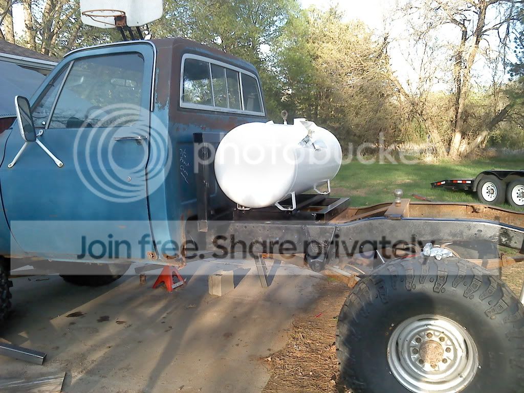

Do you have a pic of you tank installed? Just wonder how it looks size and location.

My buddy had a car tank that was about 40 gallons in his blazer and he had it bolted to the floor behind the rear seat. It was 2 tanks about 1.5" around and 4 foot long and maybe 4 foot wide. My other buddy with a blazer just runs a forklift tank and fills it at his house so 1) no one ever fills it for him and 2) he never has the top on.
