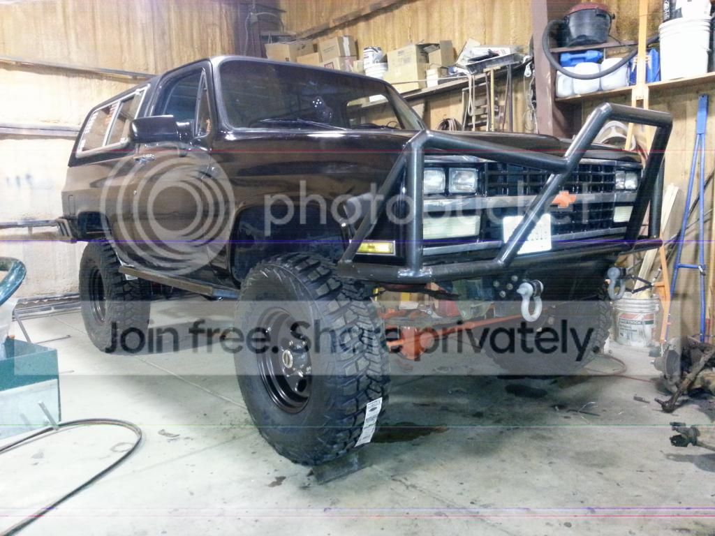

Here's what 37"x12.50" MTRs look like on 17"x8" BlackRock rims with 3.5" backspacing. Note that these are on 3/4 ton axles.
I'm pretty satisfied with how they came out :D

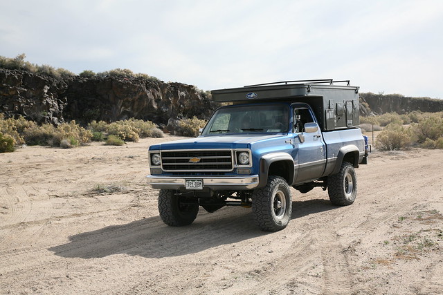

These are 315/75R16 x 8.5 with -6 back spacing (I would have swore these were -4.25 BS but the box they came in says -6). They tuck into the wheel wells nicely but yet do not rub on anything (I hate wide wheel with crazy offset that stick out). These wheels are inexpensive too. $115 through Desert Rat. I just bought a second set of these to pay the K10 back when the Suburban stole the K10s tires and wheels. On this second set Discount Tire price matched Desert Rat so that saved me the shipping to buy them from Desert Rat and have them shipped up from Arizona. Depending on the trail surface I’ll run these down to 15 PSI but typically I run 20 PSI in the front and 25 in the rear given the load of the camper. Never had a bead problem….yet
Same wheels and tires on the Burb. The only difference is the burb has a D44 front axle whereas the K10 has a D60.
