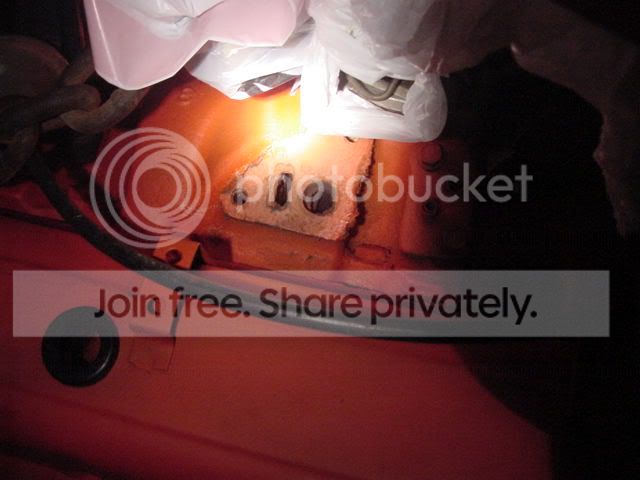

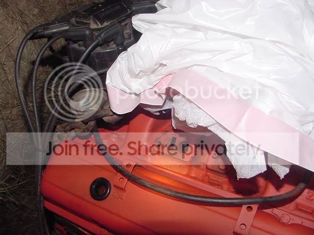

I just snapped these pics of my new motor with a flashlight.
I believe that these two places on the motor are where the EGR was removed (I think).... so how should I properly plug them?
thanks,
James
Just make a block off plate to go over it. Or I think you can actually buy one. I don't remember. Anyways, I just made a block off plate and used an old gasket.

so I make a block off plate for the thing on the left? what about the little hole thing on the right? (pardon my overly technical jargon :haha: ) got any pics of the block off plate? So I can buy an EGR gasket at the parts store?

A motor with a flashlight, $29 from QVC. KidJethro is right.:D Make your plate the same shape as the gasket.
Yeah jsut tell them you need an EGR valve gasket. Use that as a template for the block off plate. You only need to transfer the two bolt holes and the outter shape of the gasket to make your plate.

so the block off plate is $29? what is QVC? I may just make a plate, can't be too hard...
So how should I plug the stuff on the right, is that part of the EGR too?

LOL! QVC is the home shopping thing you see on tv...He was taking a stab at your flashlight/camera. An EGR block off plate certainly wouldn't be $29. Just make one, it's free.
The stuff on the right is for a hot air choke. You don't need to block those of, as all it does is carry heat from the manifold to the choke.
cool, I'll make a plate :D guess I'll try to get an EGR gasket and put a little red RVT on it for good measure.
The truck has an electric choke, so does that hot air choke thing even go with that? or was that from a previous carb?
