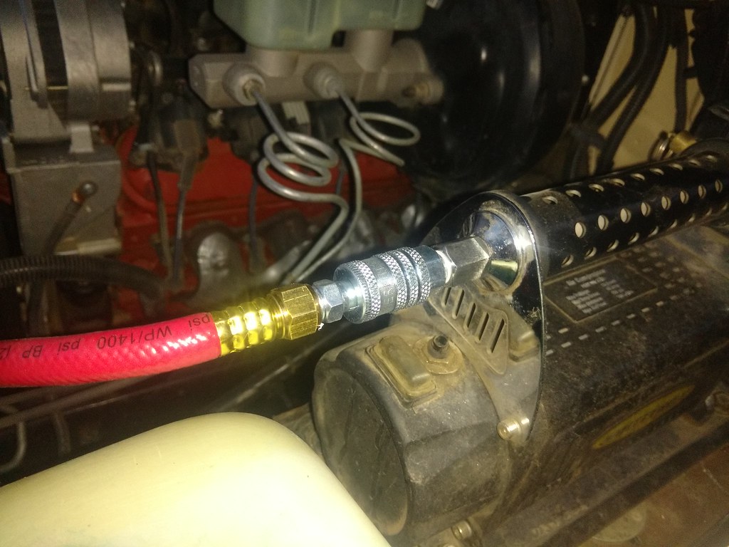

I put my ARB compressor as far forward and outboard as possible in the '90. I figured that the air coming off of the engine fan was still better than exposing it to less airflow by trying to tuck under the battery, or any road splash elsewhere.

I don't have any better shot of it, but I really haven't noticed any issue from the heat of the engine compartment effecting the compressor. I always throw the hood up when it's running anyway, unless I kick it on to fill my 3 gallon air tank I have under the radiator support.
Fixed airline by Rob Zulian, on Flickr

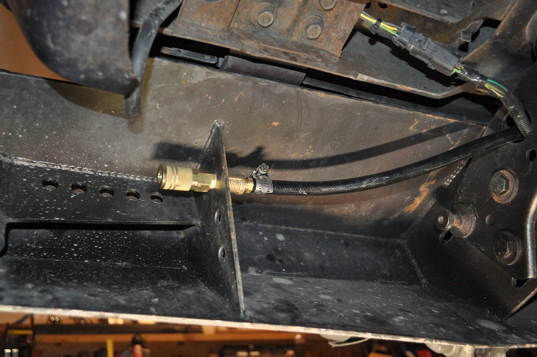

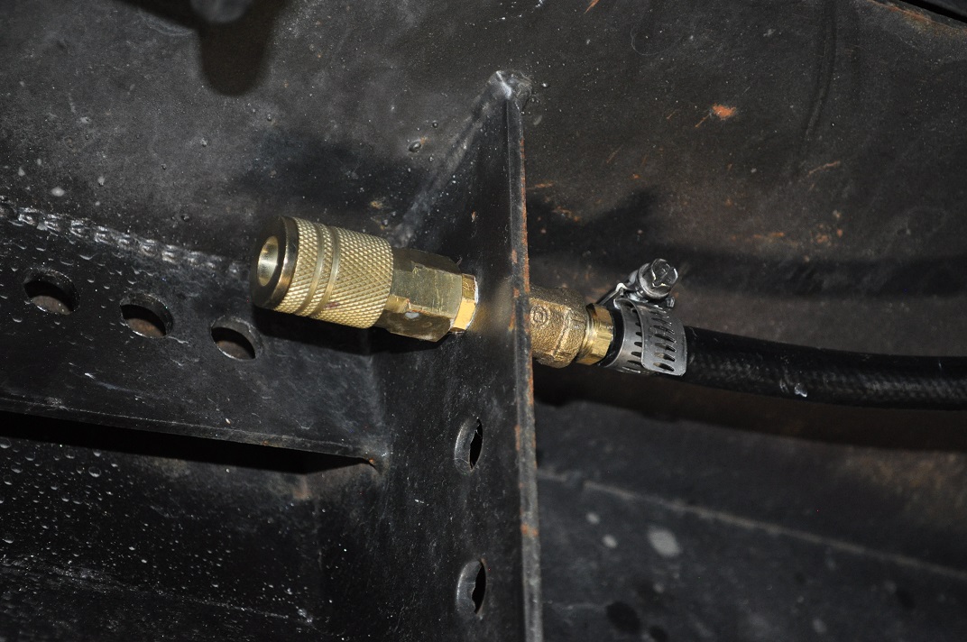

still trying to figure out how to mount the chuck on the outside in rear bumper,any one have insight on this?

got to adapt the tank fitting from 3/8 to 1/4 inch but it is a 3/4 fitting in the tank.
Being on the underside a rubber cap of some kind would help keep the air QD clean and operational
It's difficult to keep the female quick disconnect from getting trashed. What I have done to trucks that don't use it often, is put a small 1/4 turn ball valve with a male coupler end on it. It's easier to cap, or blow the chunks out, wipe the outside off, and hook up. You just end up with a hose with female ends on both ends.
ya but a rubber cap will not hold 200 psi, its the fitting on the top i have to adapt too
