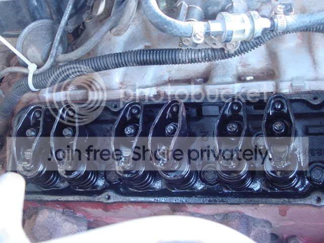

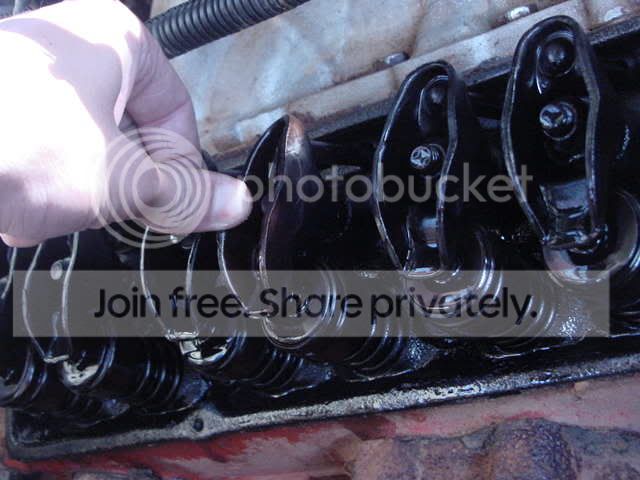

I think I found whats wrong, now I just need to figure out how to fix it. I pulled my plugs, plug wires, and HEI wire and got a buddy to tap the motor over a few times. This was with the valve covers off. All of the rockers are very loose feeling, I can shake them from side to side. One of them is so loose that it sits side ways and has TONS of play.. I don't know if its just an adjustment issue, or if its something more complicated.
What do yall think? What should I do next?

that will defently do it, adjust them how they are supposed to be and then go from there, if there are other problems it will still show after the adjustments
Would I be better off adjusting them with the motor running or not? Its running soo poorly now that I probably wont' be able to adjust them that way. I'm thinking this one may need something more than adjustment, as it actually sits a litte sideways.
Hey, that sounds familiar ... my BB, one had in fact almost come OFF, as the stud had sheared from it being loose for gods knows how long :( and only the nut was holding it in place :eek:
Replaced the stud and adjusted the lot, and she runs pretty good now.
-- A
Maybe you have a flat cam lobe :( . adjust them with it running . just back off untill the rocker starts clackin then tighten just till it stops and go a 1/4 turn more . good luck . Yes it can be a bit messy but that's what engine degreaser is for .
Pull the rocker that is sitting crooked and look at the rocker stud, i'll bet it is about sawed in half. Don't worry, it can be repaired with the head still on the engine. Check it out and see if that's what you find then PM me and i will explain in detail how to fix it.
One of those rockers is almost sideways and wicked loose, this vid should help to show what I'm talking about.
yup. something is bad, either bad lifters, or flat cam, and i am willing to bet, the person you bought it from, KNEW there was something WRONG with the motor when it was sold to you.
tighten them up, and see how it runs is all you can do now.
Oh I've walked this road before... At least your rocker is not broken in half laying on the head... You can adjust em with the engine runnning or with it off, according to the book.
You have probablly pulled a rocker arm stud, it's very common. take a flat edge and lay it across the top of the studs this will tell you if they are pullindg or not. If they are you simply pull the stud tap the haed and replace it with a screw in stud available at most auto parts stores. If not you either wore a lobe off of you cam or you have a lifter that is collapsed which really is not that bad either if it's just the lifter.
