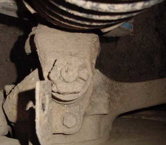

Thanks for the heads up. Is the "60F" to the right or left of the cover? on top or in front? and is it three U bolts on both sides or just on the pumpkin side?
Also what about the springs? I was thinking that for speed purposes I could just pull the shackle bolts and leave the springs on the axles. That way I could take my time with the U bolts at home. Are the springs good for any of the longer spring lift swaps I see people writing about?
just check the knuckles.
d60 is kingpin.
d44/ 10 bolt has castle nut/balljoint.
you could use the rears for the front, known as the 52 spring swap. the fronts probably wont be useful to you
It's at the bottom on the right IIRC. 2 u bolts on the driver side and one on the passenger side. There are studs threaded into the cast in spring perch for the inside up against the pumpkin that go through the inside of the spring plate. Also like mentioned there are no ball joints.
