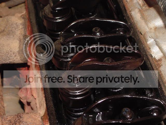

You don't see any potential problems between this:
and this?
Nope, the only problem i see is the engine on the bottom needs to be better taken care of.
