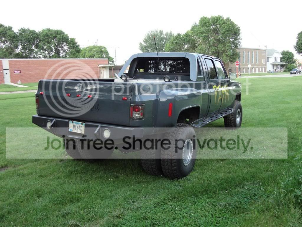

need a close up of the truck
There's a full build thread in the driveway I believe.
Specs are,
508 cadillac big block, NV4500, NP261. 14BFF single wheel converted to duals. Dana 60 in the front. 6" lift and 37's.
Some of the history, It started life as an '85 2wd 6.2 smoker. Rusted out pretty badly in the rocker panels.
Some smaller bits and pieces, on board air. 98 gallon fuel tank. Filled and smoothed in tail gate. Has a pretty nice stereo system in it. Nothing that would win any competitions but it sounds good. Air bag suspension assist in the rear.
Stuck an aluminum radiator in it not too long ago. Another big plus to the performance.
